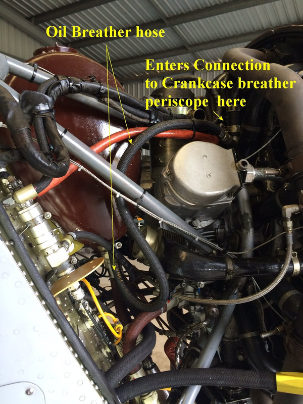

In the Mist Smile of experimenting with vents at the moment (M14 Chang). On my Chang the Oil tank vents directly to to the mid case Vent and joins the mid case vent trumpet at its base. This is fairly common on late built Changs.This was there with the Housai before I went M14. If you run the engine hard you will get Oil spatter coming out the mid case trumpet vent. The earlier ones vent the tank straight down the firewall. My Tank vent is like this:
I still get oil under the belly. seems keeping the Oil level down dramatically reduces the amount of oil splatter.
Question is what is an acceptable min Oil level. Housai based limits we know are min 13L. However M14 in YAK is min 10L for Acro and 8L min for other activities. Are these minimums acceptable for an M14 or Housai Chang ?
I have seen some mods with nose case vent T'd into the mid case vent then to the Oil tank ... then the hoping the Oil tank vent down the firewall is sufficient. Another mod is similar but an additional Oil tank vent is made down the firewall. .... still get oil down the belly. Another option taking the mid case vent line back to the firewall then down the firewall to atmosphere .... works like an old fashion road draft tube Oil everywhere !

Good use of mist! Is it ok that the vent hose from the oil tank has to go uphill to get to the crank vent? I imagine this hose will fill with oil.

Dont know its been that way since I had the aeroplane. I will be removing it for a look today will report back. its a big loop.
This is how it was with the Housai. .... is still the same with the M14
