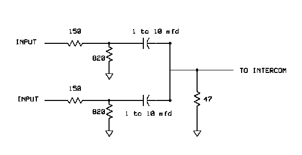

PostPosted: Tue Mar 10, 2020 11:19 am    Post subject: Re: Two Radios to One Intercom Reply with quote
Found this drawing someplace.

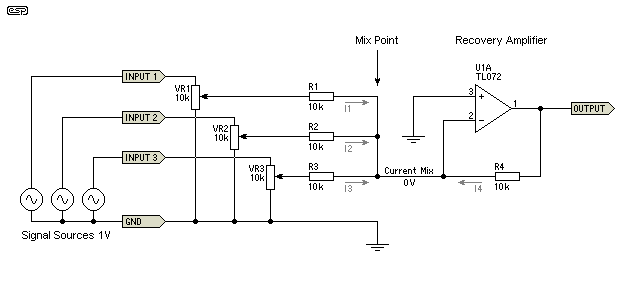

PostPosted: Wed Mar 11, 2020 5:48 am    Post subject: Two Radios to One Intercom Reply with quote
Here is an article on audio mixer circuits. The solutions presented in it involve use of an op-amp, which makes the circuit a little more complicated, but offers advantages in better gain and reduced crosstalk.
https://sound-au.com/articles/audio-mixing.htm
I'm building a mixer for my plane to combine "aux" input (2-channel stereo music, to be mixed to mono) and the alert tone from my EMS into the aux input of my VHF COM radio. This is 3 inputs rather than the two you are looking at, but the principle is the same. Here's the diagram from the article that I plan on using.
[img]cid:ii_k7ndikza0[/img]
Hope this helps.
Pat
