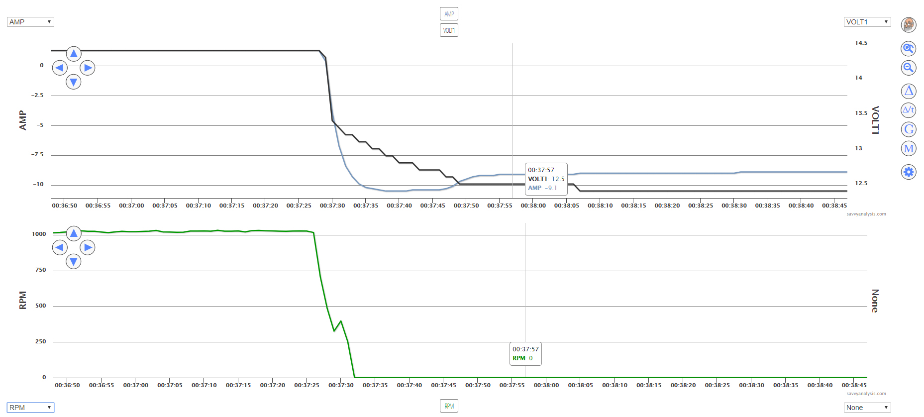

Here is a graph of a typical shutdown. You can see the draw from the battery go from about 10.5 to 9 when the alternator switch is selected off after shutdown. We have seen the alternator field draw as much as 3A and the builder noted that the alternator itself gets very hot if left on for a while with the engine not running. For this reason we don't turn the alternator on until after engine start and turn it off right after shutdown.
