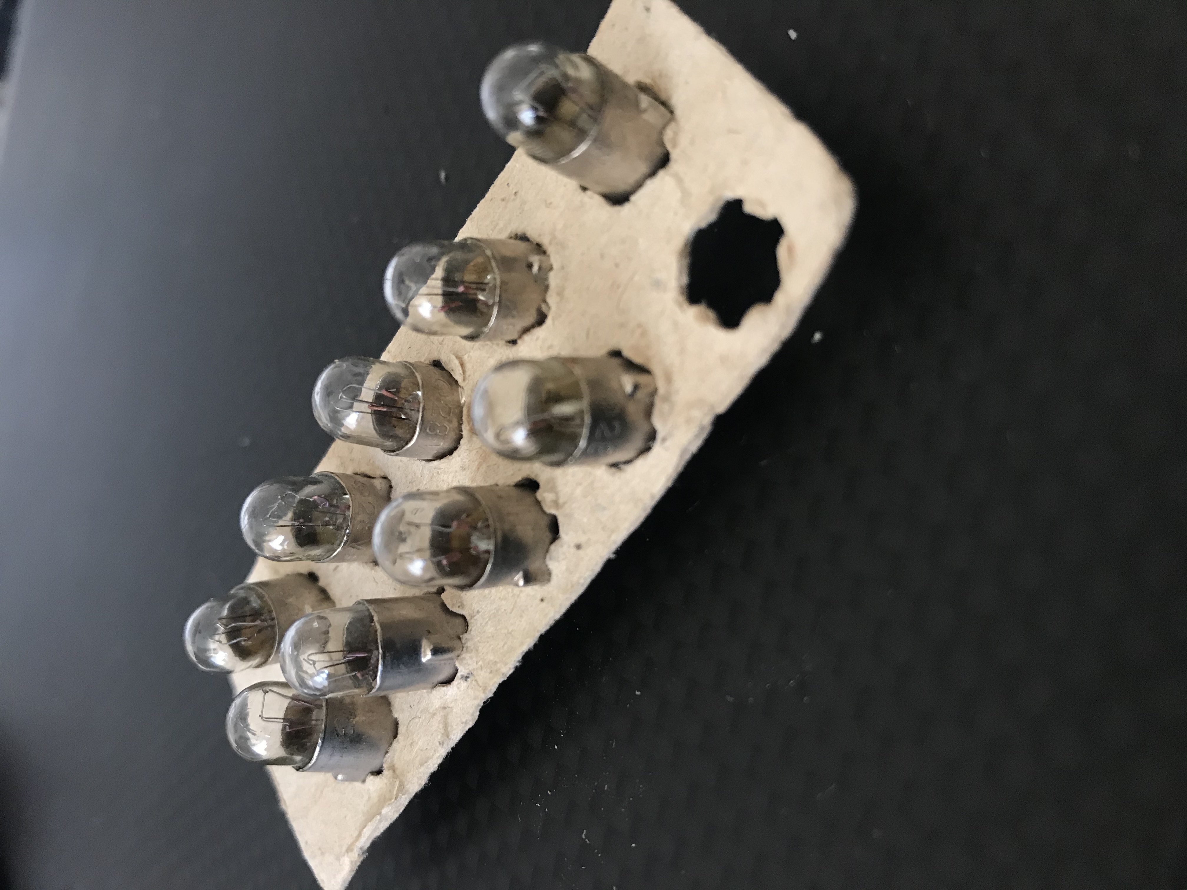

PostPosted: Fri Jul 10, 2020 1:56 pm    Post subject: YAK 52 gear/flap Indicator Bulbs Reply with quote
[img]cid:1733ab6cda3951182621[/img]
Always worth giving those Red Alert advertisers a try😎
How many do you need Greg?
Cheers
John

PostPosted: Wed Oct 28, 2020 8:59 pm    Post subject: Re: YAK 52 gear/flap Indicator Bulbs Reply with quote
Hey hey Guys!
Just wanted to chime in with my experience. I ordered 20 of the 3899 BA7S from Jackson Electric Supply. The are the correct bulb but they will NOT fit in the lens. There is a small ridge on the lip of the metal case where it meets the bulb glass.
Unfortunately in a very thorough search, there is NO 24V LED option for these bulbs. I would recommend purchasing through The Yak Collection or Aviaserv.

PostPosted: Fri Dec 04, 2020 7:35 am    Post subject: Re: YAK 52 gear/flap Indicator Bulbs Reply with quote
Yes, they will fit and work if you want to grind or file the lips off each one.
For 3$ more for each, you can purchase bulbs from Yak supporters that are meant for that application and you won’t have to file them down.
