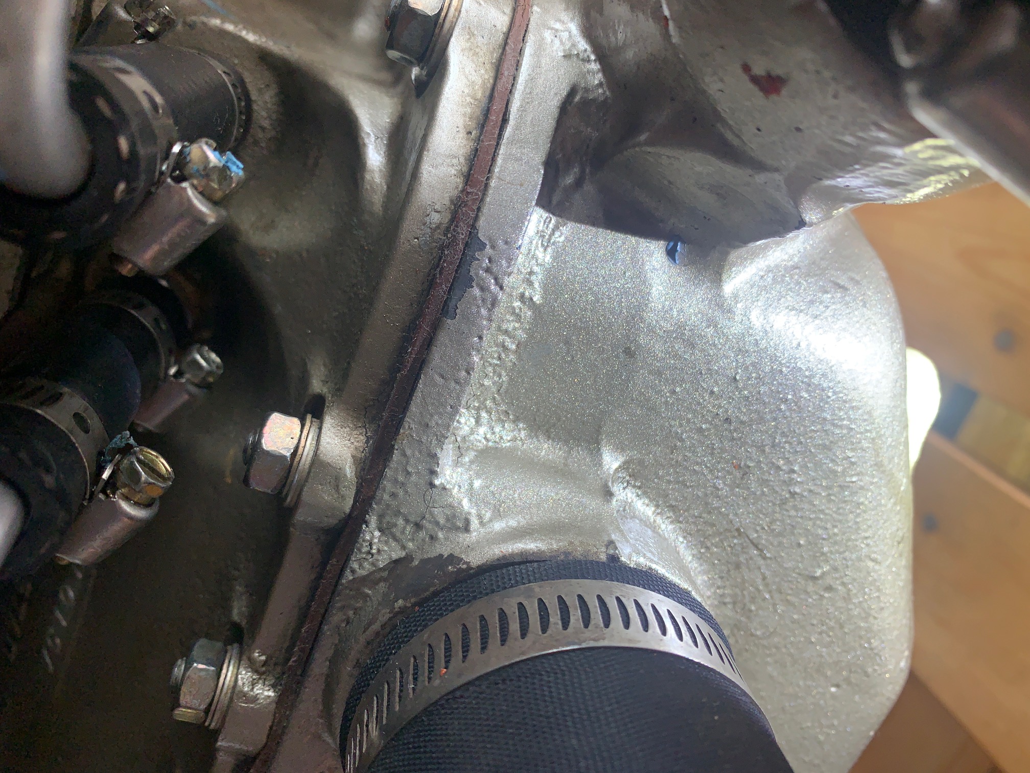

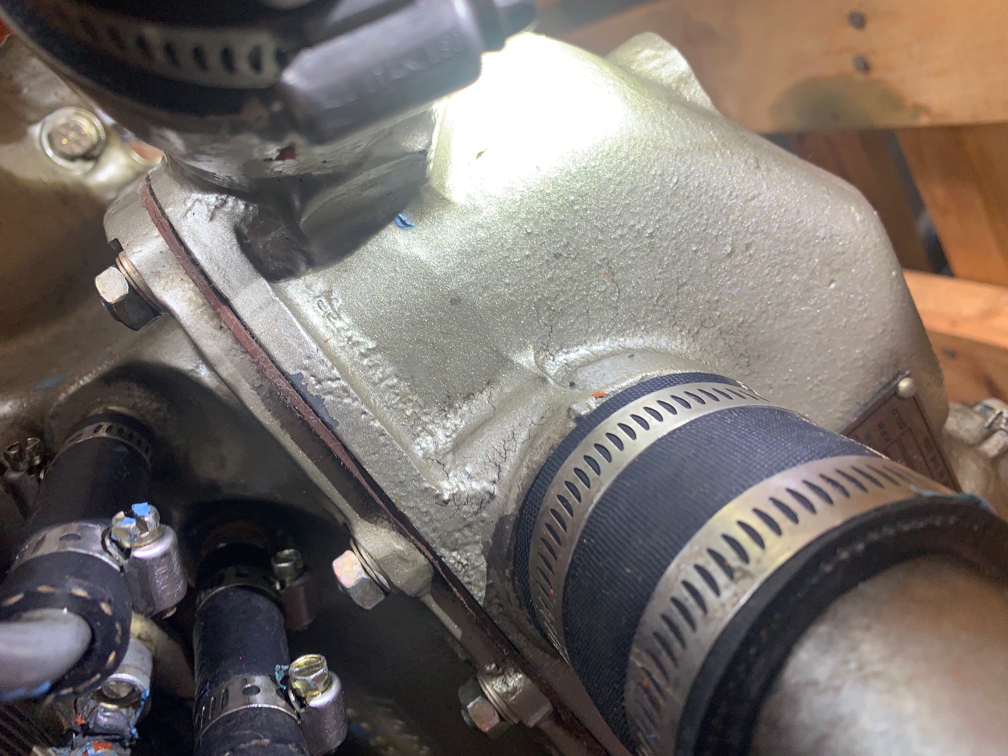

PostPosted: Thu Aug 06, 2020 11:06 am    Post subject: IO-540 for sale Reply with quote
Whew!!! Almost gave me a heart attack! Wink
It turns out that it was a bit of Oily residue from when I spray down the engine to clean it. It wipes right off with a finger. There is some in other areas of the case as well. It’s just like the way that the mineral spirits type of solvent dried. Check out the attached two photos that I just took of a neighboring spot. One of them is before and one of them is after when I wiped it up. So it’s not actually cracked at all.
oily residue from when I sprayed down the engine to clean it. It wipes right off with a finger. There is some in other areas of the case as well. It’s just like the way that the mineral spirits type solvent dried. Check out the attached two photos that I just took of a neighboring spot. One of them is before and one of them is after when I wiped it up. So it’s not actually cracked at all.[img]cid:A5662D17-9315-4733-BFE8-C26E103B6C29-L0-001[/img][img]cid:8D7B9736-A446-45D3-940A-2622BA57EAB4-L0-001[/img]

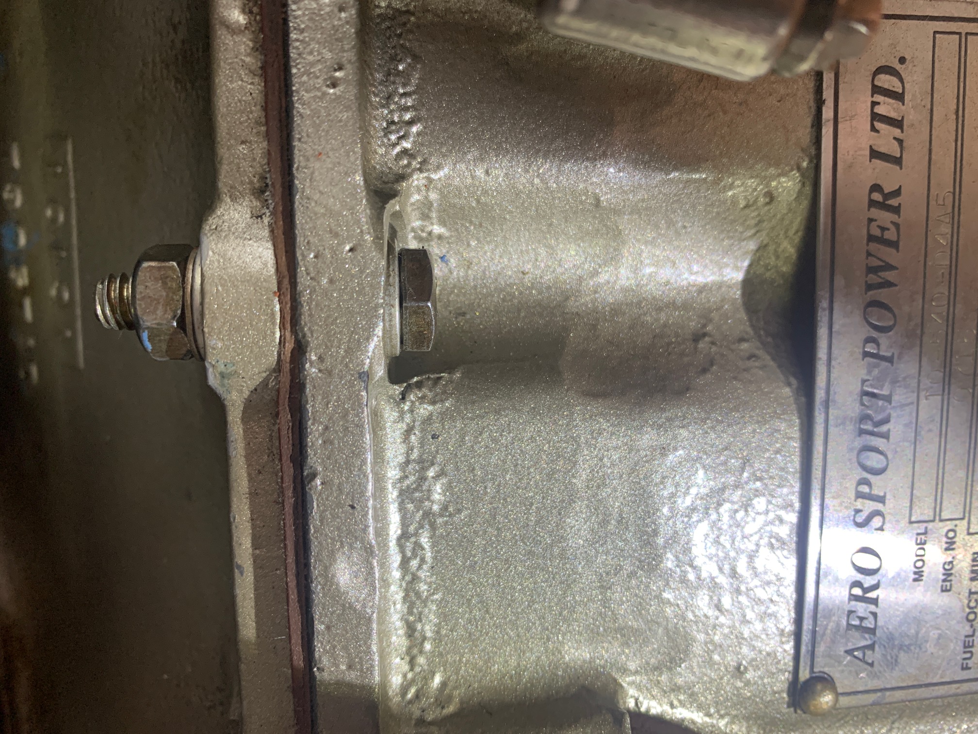

PostPosted: Thu Aug 06, 2020 11:10 am    Post subject: IO-540 for sale Reply with quote
Here is that same spot now..

PostPosted: Thu Aug 06, 2020 2:29 pm    Post subject: IO-540 for sale Reply with quote
Hi Tim,
the question is whether your cleaning method somehow worked like a die crack check. It is possible that solvents went into the crack and in the drying process somehow influenced the pattern of the surface residue and thereby revealed the crack just like the developer does with a die spot check. You can also wipe away the red die after the crack test and the crack seems gone but it is not.
I am not claiming that there is a crack but I am saying that it might be good to do a die test at that very spot and make sure.

PostPosted: Fri Aug 07, 2020 1:46 pm    Post subject: IO-540 for sale Reply with quote
Martin,
I had the FBO bring over its dye penetrant kit today to check that
area, just in case you were right.  Turns out it really just was
grease residue like I thought.  I washed everything down
and when the residue dried it left a fine-line jagged greasy
trail that from a distance in the photos you could mistake
for a crack.  But in the end , there's nothing there but nice paint.
Those cases are sand cast which gave it the necessary
roughness for the oily residue to take that shape.
Tim
