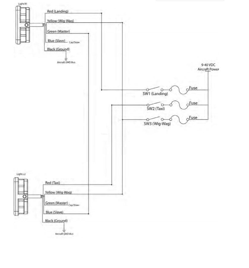

Hello all again.
I want to install AeroLeds Aerosun landing and taxi lights. Two lights total, one will be oriented for taxi attitude and one slightly higher orientation for the landing light attitude on my tail dragger. That said, my thoughts, since these lights have a built in wig-wag function, are to do just that. However, I cannot figure out how to wire it.
According to the install guide for the lights, it says to have 2 switches. One for the landing lights, and one for the wig wag function, which is fine if you are using both lights as landing lights. Since I want one light as a landing light and one as a taxi light, but use both for the wig-wag function, how does that work switch-wise? One switch as OFF-Taxi-Both, and the other wig-wag? There isn't enough information to know if when the wig-wag is "ON" the other switch is bypassed? Am I thinking along the right lines? Better way to do this?
Any help? I've attached the install manual wiring diagram...
Thanks so much!
Rob

PostPosted: Sat Sep 19, 2020 8:03 am    Post subject: Landing and Taxi lights wig wag Reply with quote
Hello Rob, I think you are overthinking it. By all means aim them differently so that you have the best lighting for both landing and taxi, and using the wig wag function is better than not using the wig wag function regardless of which way they are aiming, but why not just wire it exactly as per that drawing? Are you ever going to need to turn off just one light?

PostPosted: Sat Sep 19, 2020 8:27 am    Post subject: Re: Landing and Taxi lights wig wag Reply with quote
Well, I thought of that as well, and thanks for the response! I am quite sensitive, because of my real job, to people blinding each other during night taxi ops. I feel it’s quite unneighborly and don’t want to be in that position. Great point though...I’ll have to think on it a bit more. In either case, I’d like to know if it would be possible to do what I’m asking.

PostPosted: Sat Sep 19, 2020 8:59 am    Post subject: Landing and Taxi lights wig wag Reply with quote
Install a separate switch for each red wire.

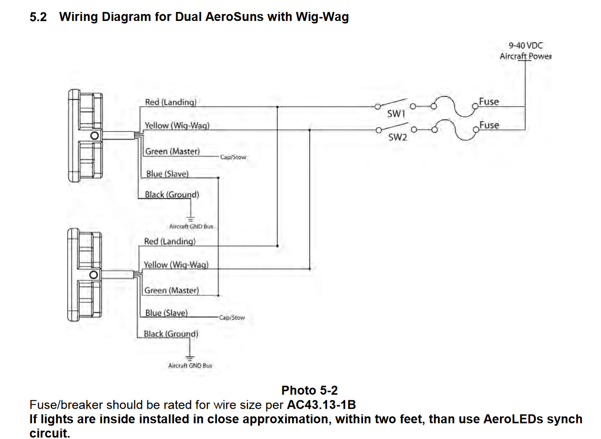

PostPosted: Sat Sep 19, 2020 9:40 am    Post subject: Landing and Taxi lights wig wag Reply with quote
Here's figure 5.3, but with the center lights and optional diode removed.  I think that's what you're after.
5.2 would give you two landing lights that wig-wag.  Not quite the same.

PostPosted: Sat Sep 19, 2020 11:05 am    Post subject: Re: Landing and Taxi lights wig wag Reply with quote
Hi Rob I just did exactly what you want. I used 3 switches. I checked with AeroLED and you can't hurt anything no matter how many switches you have on at once. Just Wig Wag will Wig Wag. Landing on and Wig Wag will Wig Wag. Taxi on and Wig Wag on will Wig Wag. Both Landing and Taxi on and Wig Wag on will Wig Wag. Note when turning on Wig Wag both LEDs will light together for a short time at the same time. I have a an Aerosun Landing and Microsun Taxi. I'm using 7 1/2 amp fuse for Wig Wag, 4 amp Aerosun and 3 amp for Microsun. I have mine located within a few inches of each other. Ron P.

PostPosted: Sat Sep 19, 2020 12:58 pm    Post subject: Re: Landing and Taxi lights wig wag Reply with quote
Much obliged, Dave! I didn’t think to use that diagram because it had too many lights on it...haha. I need to think out of the box I guess.

PostPosted: Sat Sep 19, 2020 1:03 pm    Post subject: Re: Landing and Taxi lights wig wag Reply with quote
Sound good Ron! Thanks so much. That’s the info I was looking for.
Since that’s the circuitry for the wig-wag, I suppose it wouldn’t be difficult to combine the landing and taxi circuits onto one double throw switch...you agree? I’m trying to minimize my panel layout...
