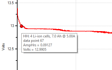

At 10:58 AM 10/4/2020, you wrote:
--> AeroElectric-List message posted by: "bobnoffs" <icubob(at)gmail.com>
the rub with low voltage indicators is that they set their low voltage for lead acid batteries. this is too low and useless for earthx lipo. low voltage warning must go on below 13.5 volts. when i started this post i talked to b and c about a warning system they had. the voltage was not adjustable and set for lead acid......no good for lipo. b and c said that most electronics is adjustable today and there was never a market for a higher low warning. my system is adjustable but i do not want to probe my ecu with my computer just to make a limit change.
earthx users....what's in your wallet? er i mean low voltage setting?'
Not sure I understand this. Check out this family of
discharge plots on 3 brands of LiFePo4 batteries
including an EarthX.
https://tinyurl.com/y4nsp8lr
Looks to me like 13.5V is still a good number.

without any mod the ''idiot light'' comes preset to warn below 13.0 volts. in a lead acid set up this would catch the alternator soon after it went off line and a lead acid would have most of its charge left. when a lipo drops below 13 volts a lot of its charge is already been used. the goal is to catch the alternator going out, not to monitor system voltage. my engine needs a battery or a working alternator to keep running.

without any mod the 'idiot light' comes preset to warn below 13.0 volts. in a lead acid set up this would catch the alternator soon after it went off line and a lead acid would have most of its charge left. when a lipo drops below 13 volts a lot of its charge is already been used.
Can you confirm that assertion from the
data offered in the three plots I've
posted?
The testing I've done suggests that
there MIGHT be a bit of delay in the
LV WARN response . . . but it's minimal.

See tabular data text file. The ETX36 with a 5A
load on it will fall to 13.0 in about 40 seconds.
The image file is from plotred data of the same
test:
Kinda hard to zero in on the finer details of a
couple hour run but it shows that at 67 seconds,
the battery was down to 12.99 with an expenditure
of approx 0.1 AH
Keep in mind that voltage monitoring at
the bus is always tens of millivolts HIGHER
than battery voltage . . . with a similar
departure to the LOWER side during DISCHARGE
conditions.
So assuming one had a LV reporting system that
was not adjustable but accurate to 100 millivolts
or so at 13.0, the resulting delay between
alternator failure and annunciation is still
timely and 'wasted' energy is trivial.

That's an open circuit, no-load voltage that speaks
to state of charge. That's not a milestone voltage
for a fully charged battery under load.
Two completely different conditions

And in what way does the data I've posted
argue with that?
The AeroVoltz plot shows a working range
on the order of 13.2 to 12.5 volts.
Miady 13.2 to about 12.0
EarthX from 13.2 to 12.5
Where are you going to find anything
flatter for a discharge curve? All three
deliver power within a 5% or smaller
window.
I have always seen a much larger % drop advertised.time for me to call earthx.
