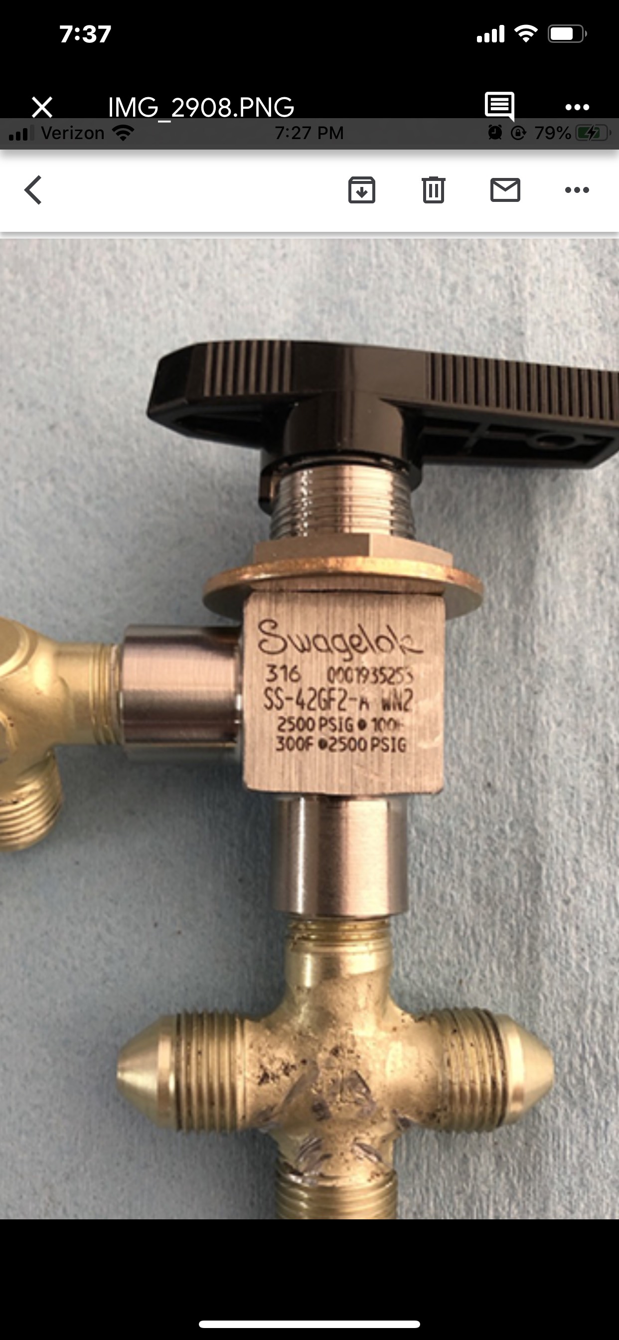

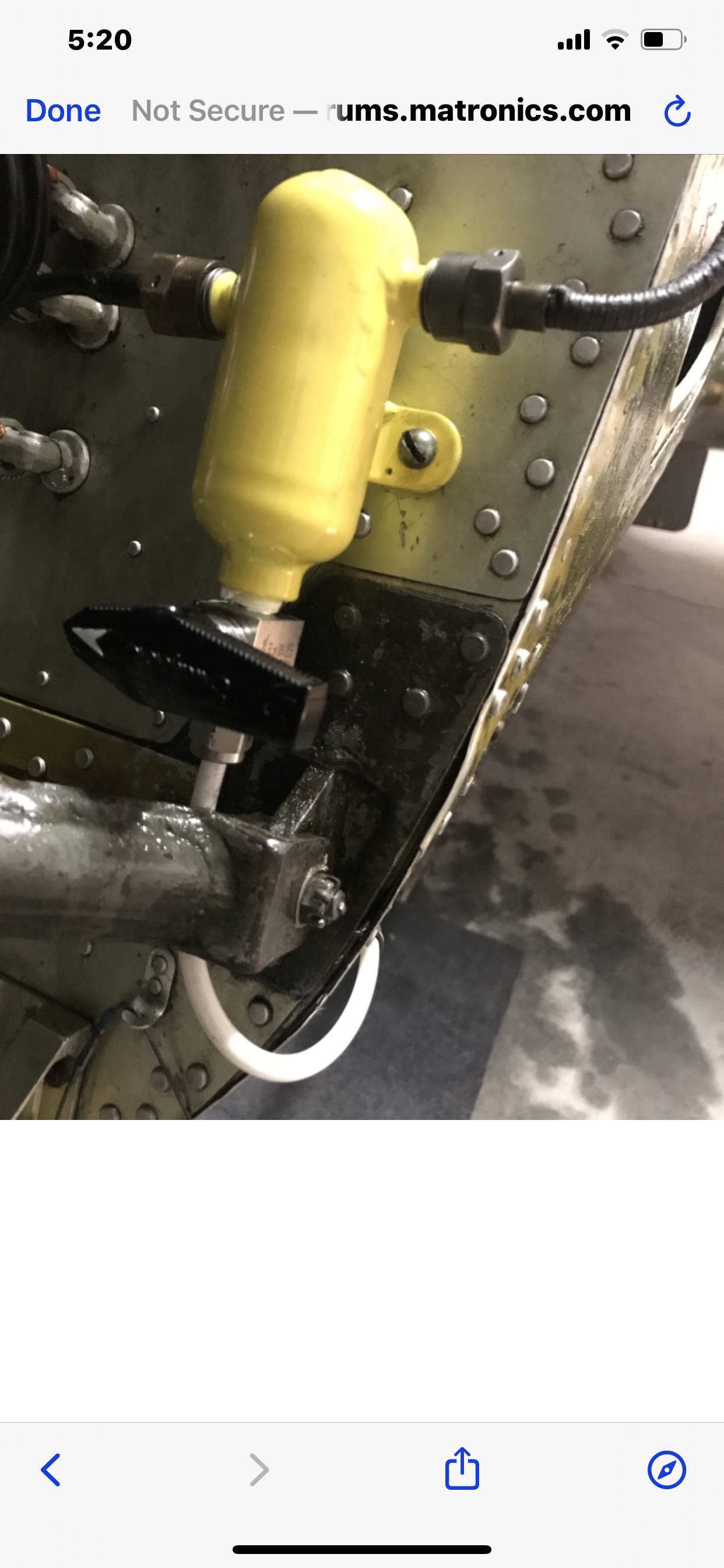

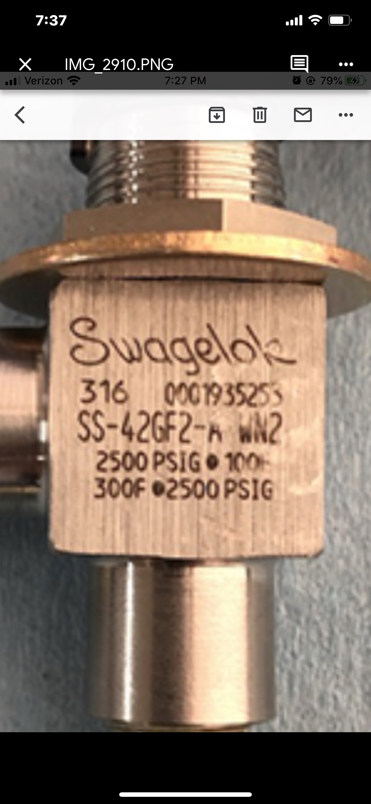

Jay
I use the all stainless steel valves the Doug supplies.
The photo is from a Yak list post from before.
I hung onto it in the event I couldn’t get a Chinese stainless valve.  This is the valve for the main and emergency valves.

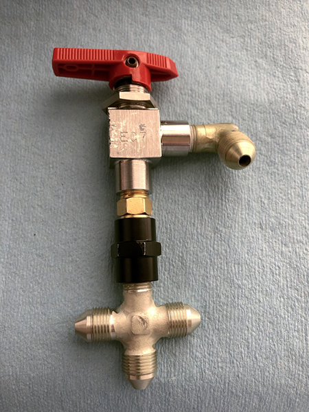

Here is a picture of my CJ emergency on-off valve with adaptors that duplicate the original line positions. The Yak-52 probably requires different adaptors. The black handle valve for the main air is Swagelok part number SS-42GF2-A-WN2 and the emergency air red handle part number is SS-42GF2-A-RD-WN2. I suggest placing about 4 turns of nylon tape on the threads to lessen the likelihood of leaks. Replace and forget.

Both the Chinese adaptors and the Swagelok valves are ⅛-27 NPT pipe thread.

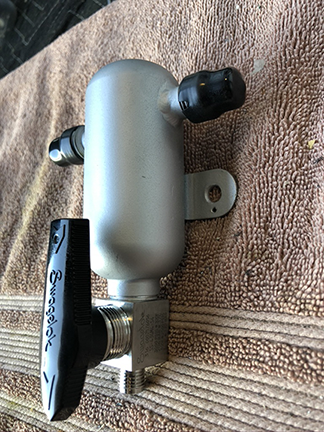

Here is a photo I saved of the snot valve with a swagelock valve.
At the time the post did not give a part number.
Maybe someone will recognize the valve and share the part number
Mark

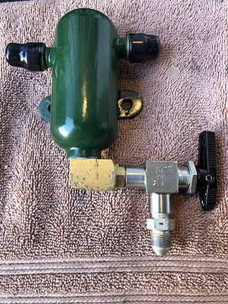

Hello Mark,
For the Yak-52, it's the Swagelok SS-43GM4-S4.
For the CJ, a typical install requires a right angle adaptor and a different right angle Swagelok valve. If you need this part number I’ll get it later today.
Attached are some images.

One additional item. If not already done. The bottom thread of the snot bottle will need to be tapped to accept the input side of the Swagelock valve, which I believe is ¼-inch NPT. After completing the tap, be sure to completely wash out the many small metal fragments produced. It’s helpful to do the tap a little less than you think is needed and then screw int the Swagelock valve until it is tight. If a ¼ to ½ turn more is needed to properly align the value, run the tap just a little more. This way the final valve position will not end up at some odd angle.

Jay
Mark
N621 CJ
<IMG_4524.jpg>
On Sat, Oct 31, 2020 at 8:14 PM Warren Hill <hill(at)doctor-hill.com (hill(at)doctor-hill.com)> wrote:

On Nov 1, 2020, at 8:53 AM, Warren Hill <k7wx(at)earthlink.net (k7wx(at)earthlink.net)> wrote:
Warren Hill
N464TW
Mesa, AZ
<Swagelok.jpg>
