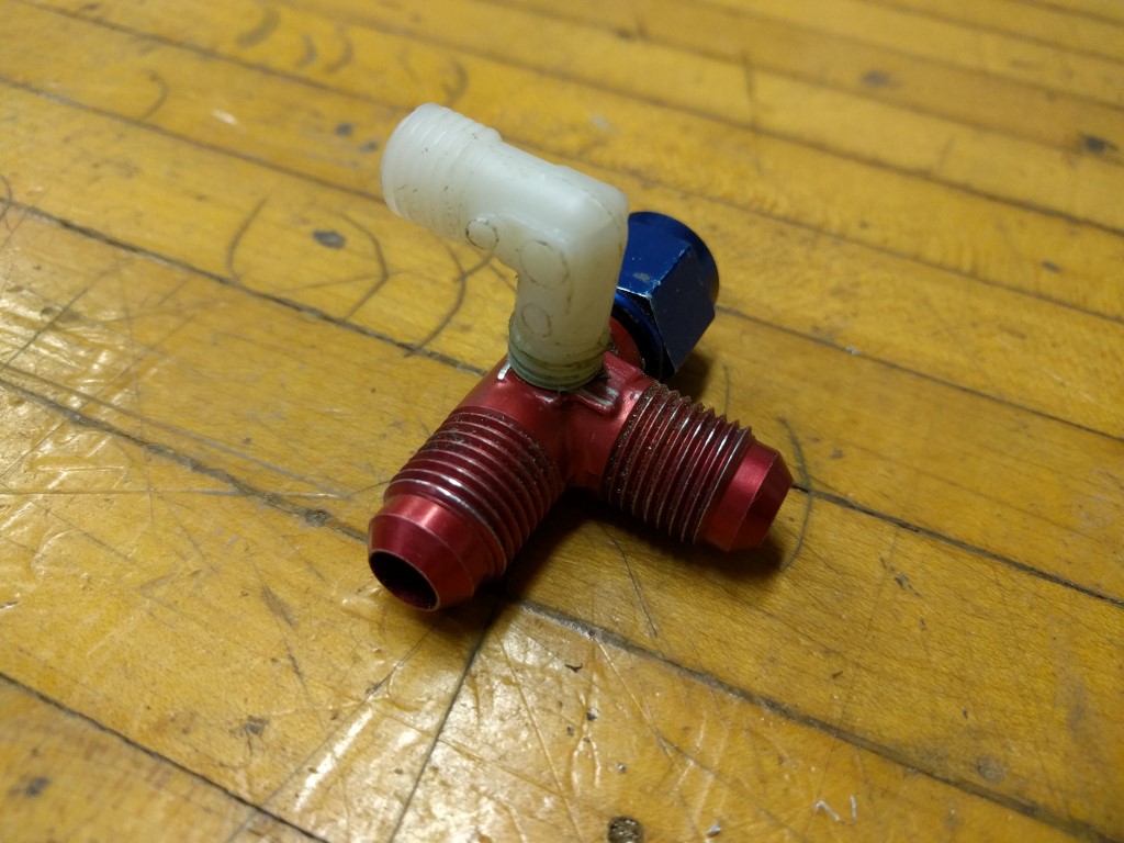

Knowing that makes the solution a lot simpler; I was working on the assumption that you couldn't tap the lube reservoir. If it's pressure-lubed by engine oil, just use a return line fitting in the case that's tapped 1/8npt for the sensor. You can buy them already drilled & tapped, or drill & tap one yourself. Attached is an image of one I drilled/tapped, with the 1st 1/8npt fitting that was handy. If the return line is a -4, then use a T fitting with the sensor tapped into one leg of the T. (Complete info is helpful to help find solutions.)
That method will tell you the oil temp *after* the gearbox heats it up. Be sure of the mfgr's specs; if they spec oil *inlet* temp (most common for engine oil temp specs), then you'll scare yourself unnecessarily. Ideally, I'd want both inlet and outlet temps, so I could see temp delta through the box. If you only have one sensor input available on the monitor, you could achieve that with a simple double throw switch in the sensor lines.
If you don't like those ideas, you could always tap the drain plug itself for the sensor (if it has one).
Hope that's useful,
Charlie

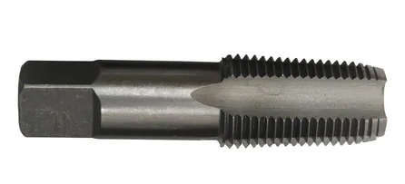

PostPosted: Fri Nov 20, 2020 7:54 am    Post subject: heat probe Reply with quote
At 05:31 AM 11/20/2020, you wrote:
--> AeroElectric-List message posted by: "bobnoffs" <icubob(at)gmail.com>
the chip detecter looks like a good idea but i don't have a place to mount it. it is way over my head to drill and tap a hole in the gearbox case.
maybe down the road it would be a job for someone competent when it is inspected.
Adding a pipe-thread hole in the casting is
probably the easiest of tasks. Straight thread
taps are not 'self aligning' and it's too easy
to have your tap start cutting on a slightly
axially mis-aligned orientation. Pipe threads are tapered
and they start cutting with a minimum of attention
to position and force . . . you can concentrate
on axial alignment and the tap takes care of the
rest.
