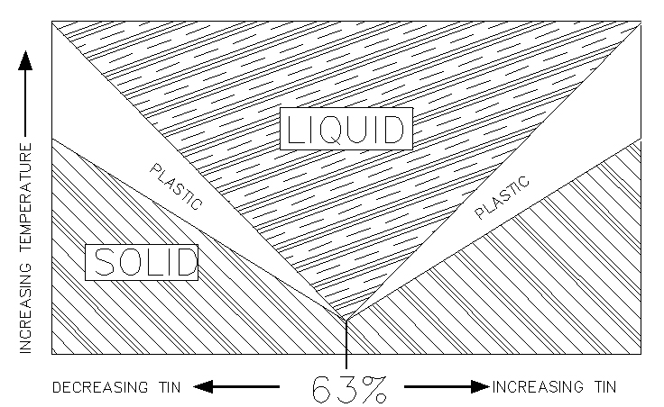

Use only 63/37 (or at worst 60/40) tin-lead solder.
You can't make a 'cold joint' with 63/37 solder
if you tried.
Recall that 63/37 solder's phase diagram has
no 'plastic' range. This means that as the
solder cools, it passes very quickly from
liquid to solid giving you no chance to
scramble the matrix of semi-solid melt
creating a weak and porous mass.
So if you're attempting this fat-wire
termination for the first time, do practice
a bit. Install a couple of terminals on
scrap wire first.
