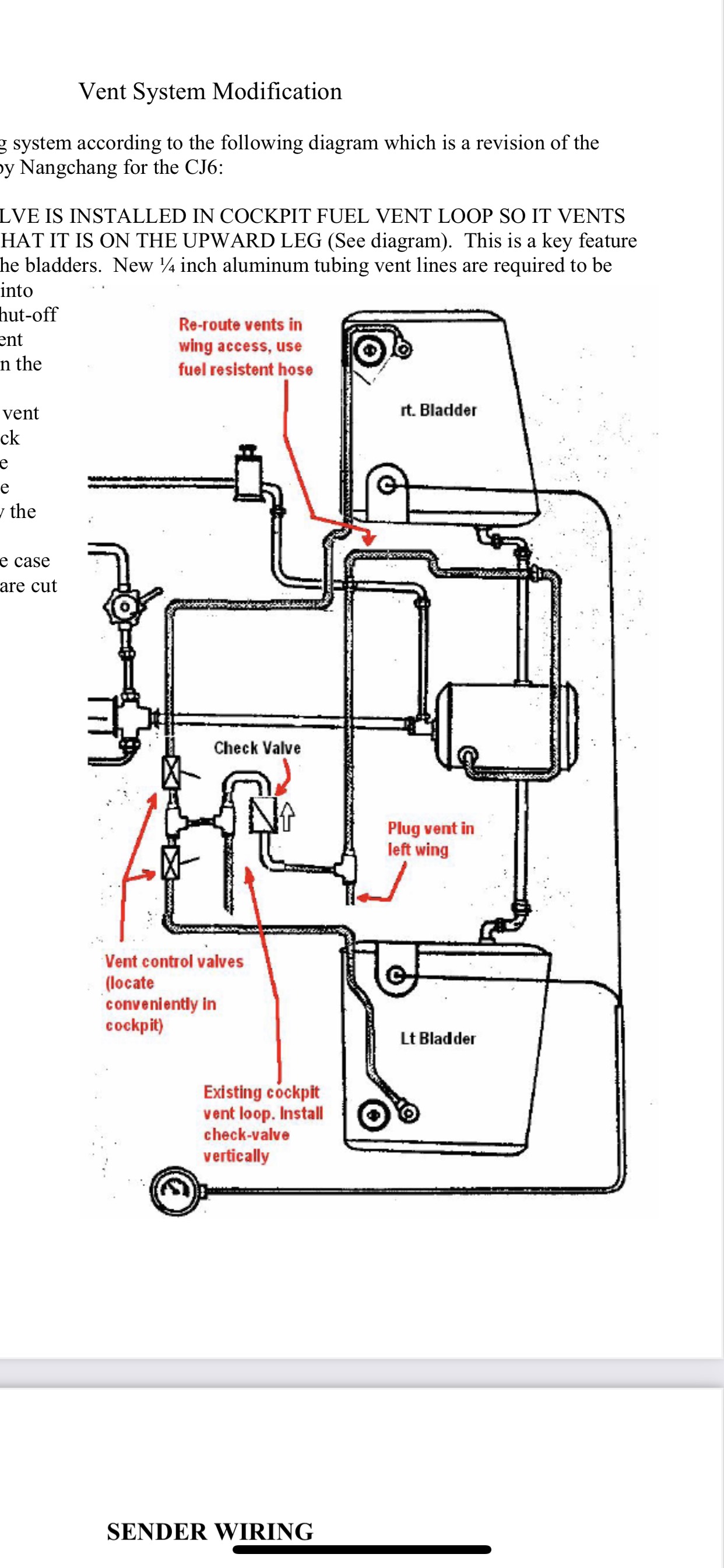

I have bladder tanks so my vents are extended to their respective wing tips
 with a separate vent for the header tank. I find that I tend to fly more p
ressure on my left rudder because my knee board is on my right and lifting
my right knee a little makes writing easier. This tends to cause a noticeab
le fuel difference over a 2 hour period. I know, bad pilot bad. Very early
on before I had my bladder tanks installed, I had to do an emergency divert
 because my one tank was almost dry and the opposite tank wasn't moving the
 needle yet. Only after landing I noticed the needle move. Constant fuel ma
nagement has become the norm. I optioned to not install the vent shut off v
alues after and incident I had with another RPAer. This pilot closed one of
 his vents to overcome the fuel flow difference and forgot to open the vent
 again. On roll out with the engine pulled to ideal, the engine died on the
 runway. It would start but than die again. When we got it to parking, we n
oticed one bladder tank was sucked flat and dry..... The same side with the
 closed vent. Human factors are human factors! Unless you design a system t
o incorporate some warning when the pressure builds or the vent is closed i
ndication, this only complicates memory items that needs to be attended and
 eventually can lead to failures.

I fly a CJ6 with the bladders so not stock tank or vent piping.
When I was having this problem I consulted another CJ owner with a bladder system ( you know who you are and thank you)  and he pointed out after some photos were sent to him that my tube extending from the bottom of the plane was most likely not long enough to be in the slipstream and apply the pressure to the vent system and the top of the fuel in the tanks.  I extended the tube about 3/8" farther down and it cured my tank imbalance.  Also, what I do about every third flight or so is I put a hose on the vent tube extending from the bottom of the plane and open one fuel tank at a time and blow through the system and clear the vent system back to the tank.  I close that tank and open the other and repeat.  Sometimes I can tell I am clearing something from the vent system back into the tank.  Most likely fuel.  I dont fly straight and level very long when I go out.
I make sure the ball is centered and pay attention to wings level and I rarely come back with a fuel imbalance.  I did inspect the flapper valves during one of my condition inspections and made sure they were clean and freely moving but made no modifications to them.   I usually refuel after the flight and before I put the plane in the hangar.  Usually the tanks are within 1 to 2 gallons of each other... A couple of times,  I have come back after a couple of hours of flight time and one tank was down much farther than the other.  Before I put the plane away , I put the hose on the vent tube and could tell one tank's vent system was plugged.  So the imbalance made sense.
Hope this helps.
Mark

>     Many people have noted the fuel feeds from the LH tank first.  That i
s not surprising since the LH  vent system is much shorter than the RH and
the tube is 8 mm (6 mm ID) for both.  Not a huge problem as long as the
>     tubing is internally clean and totally free of any damage that could
restrict air flow. This is critical!  There is also some minor effect favor
ing LH flow via the shorter fuel feed line to the header tank.
>     The major design problem rests with the header tank flapper valves.

We really should have an emergency vent of some type in the CJ.  ONE is
not enough!    In the T6/Harvard (and most aircraft) each tank is
separately vented.
Over the years I have seen three T6 fuel tanks where you could touch the
tank bottom from the filler hole due to a plugged vent.

Hey Walt.
Hope everything is going well on your end.  I dont use shop pressure. I use whatever pressure is in my lungs.  I blow into the hose like you're blowing up a balloon.   When you install the bladder system you put a check valve in the vent loop behind the pilots left shoulder.  That check valve keeps air from getting to the header tank but allows fuel to escape if need be.  So when you leave one bladder open and blow into the vent on the bottom of the plane you're only clearing the line to that tank back to the tank and the check valve keeps the air pressure off of the header tank.  The check valve is mounted vertically with the ball closing the check valve due to gravity and or pressure coming into the vent system through the tube out of the bottom of the plane when it is moving.
Then I close the first bladder and then open the other one and repeat.   The system was in when I got the plane so I have no experience with the stock system at all.   Nor did I install this one.  I did verify my system is installed as the attached diagram shows. When Gil was with us he explained the vent system was put in like this to make sure the bladders would empty completely.
I attached the diagram for installation of the check valve as part  of the bladder system for the CJ.

Many people have noted the fuel feeds from the LH tank first.  That is
favoring LH flow via the shorter fuel feed line to the header tank.

PostPosted: Tue Dec 08, 2020 2:20 pm    Post subject: Yak-List Digest: 4 Msgs - 12/07/20 Reply with quote
If you use bladder tanks but didn’t install the wing vent shutoff valves, this diagram won’t work.  If you vent each tank to the wing tips instead of the cockpit, with the check valves in this configuration, you will blow fuel out the belly vent.  Because the tanks are now at a higher pressure, the pressure is relieved through the Hopper tank and will vent fuel out the belly vent.  With the vents at the tips, you need to turn the check valves around so air blows into the hopper tank, thereby pushing fuel and sucking air to fill the flow void. With wing vent, there is no vent connection between the tanks and the hopper.
Sent from Yahoo Mail for iPhone
On Tuesday, December 8, 2020, 13:42, Mark Pennington <pennington.construction.inc.1(at)gmail.com> wrote:
Hey Walt.
