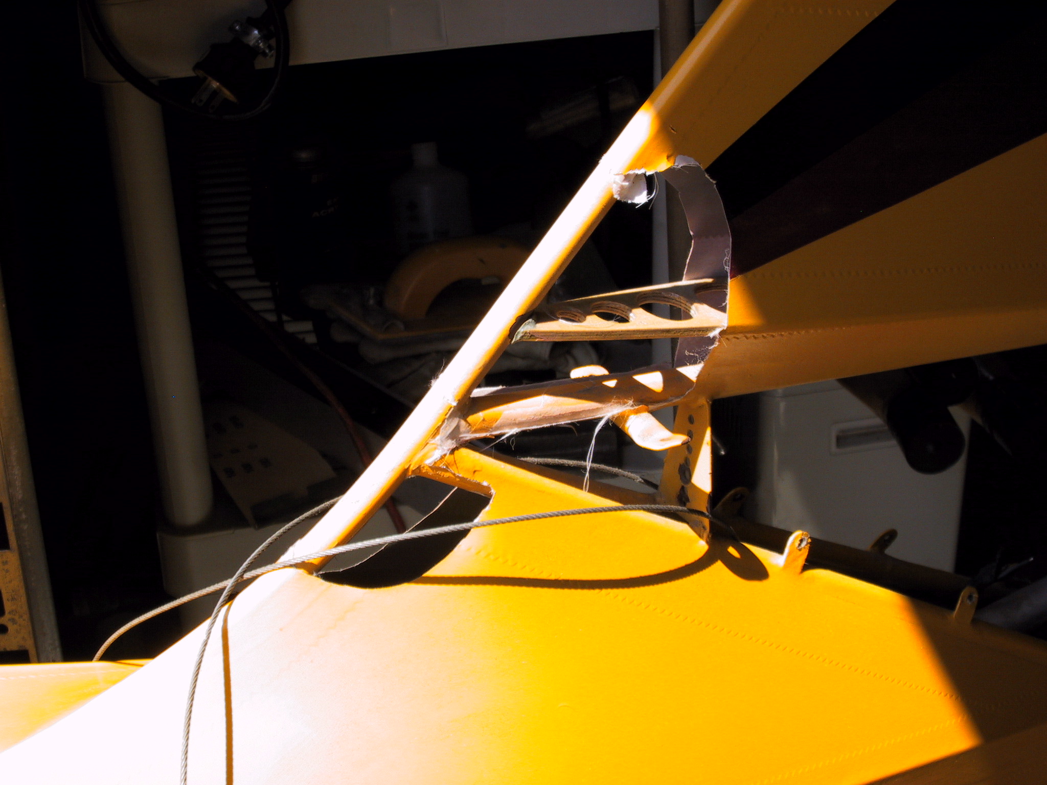

I have a couple of areas where the fabric must be repaired after it was cut away to assess the structure underneath. In some cases it's just as easy to replace the whole area, but on some such as the tail area below the stabilizer I want to patch it. The Polyfiber manual says to sand off the aerothane, technique is probably important, anybody engaged in this activity?
Here is a picture of the affected areas.

This is how I removed aerothane for a tube repair! first you use any
hardware store paint stripper, brush it on but don't turn your back it works
fast. The paint stripper will soften up the aerothane so you can scrape the
aerothane off. next you will have to clean the bare fabric then reglue new
fabric on and paint. now make sure you use white paint over the silver so
that your yellow will blend good. I have photos of my repair if you like.
Ray

Thanks Ray, and also Jeff who replied offline. I'll try it with the old MEK
(which by the way is the same mix of MEK, toluene and another that the loacl
auto paint store sells) and a paint remover this weekend. I'm learning to
dislike aerothane, if I had built new I would certainly go with polytone.

Aerothane is a pain to repair, but sure looks nice! forgot to tell you,
while your using the pain stripper, make sure the fabric does not roll up on
you. I used a small block of wood under the fabric while I was removing the
old aerothane.
