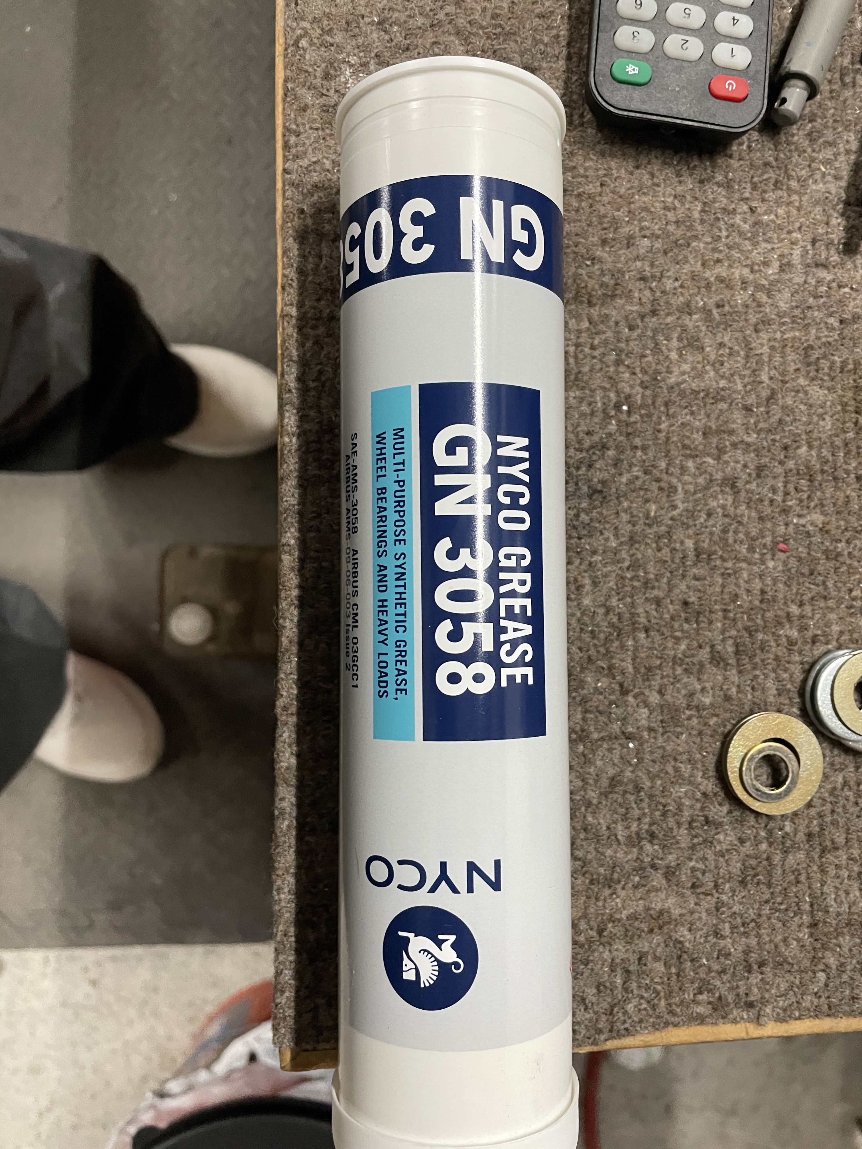

Btw, Hartzell recommends a new grease now, so if you do get an overhaul, grab a couple of tubes from the prop shop, as it’s otherwise unobtanium from the popular aircraft parts stores.

As for the grease in the prop, you should use whatever the prop shop
installed when it was last reassembled, and there should be a sticker
identifying that grease. Most until recent years used Aeroshell 6.

On that note,I read recently that hartzell started using a new grease not long ago. So if you have a new prop or get an overhaul or reseal, make sure to verify the type of grease because you may need to order that special type of grease from there on.

PostPosted: Sun Jan 03, 2021 3:21 am    Post subject: When to service the propeller? Reply with quote
Here’s a photo of the new grease Hartzell is now using.   It appears that it’s only available through Hartzell authorized service centers.  The shop I used wanted $20~$25 per tube.
It would be nice if one of the major retailers would start stocking.  I suspect it may take some time for them to begin aware of the change and demand to warrant stocking.
If anyone finds alternate sources, please let the list know.
Bob

The only one I found is:
https://www.skygeek.com/nyco-gn-148-blue-grease-400-gram-cartridge.html
$23

PostPosted: Sun Jan 03, 2021 9:24 am    Post subject: When to service the propeller? Reply with quote
The manufacturer describes is as follows: (interesting that they list it as a wheel bearing grease)
The newest high-temperature range grease for longer wheel bearing lifeDESCRIPTION
NYCO GREASE GN 3058 is a white lithium complex thickened synthetic grease designed to operate in salty and humid environment in a very wide temperature range going from -54°C to +175°C.APPLICATIONS
  • Wheels
  • Landing gears
  • Heavy loaded systems
MAIN BENEFITS
  • High load carrying capabilities,
  • Outstanding resistance to water washout and to high temperatures,
  • Very good protection against corrosion even in the presence of salt water.
On Sun, Jan 3, 2021 at 10:47 AM Lenard Iszak <lenard(at)rapiddecision.com (lenard(at)rapiddecision.com)> wrote:
