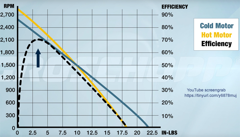

Take a peek at the attached exemplar DC
motor curve. Note that for a FIXED applied armature
voltage, motor performance is plotted by a straight
line running from max rpm at zero load to max torque
at zero rpm. This load line has SLOPE that is
defined by LOOP RESISTANCE. Add up all the resistance
for power supply source impedance, wires, brushes and
armature to get total loop resistance.
Divide that value into source voltage and you
get a value of absolute maximum current which
occurs at zero rpm (stall current) which is also
your start-up, inrush current.
Note that at zero rpm, max torque and stall the
available voltage is not changed. There is a FAMILY
of lines, parallel to the blue line that represent
a range of applied voltage. The slope is constant
as long as loop resistance is constant. Note the
yellow plot showing an increase in max rpm at zero
load; drop in torque (and stall current) at zero
rpm. This illustrates a 'hot' motor condition due
to increased resistance of the armature windings
due to temperature.

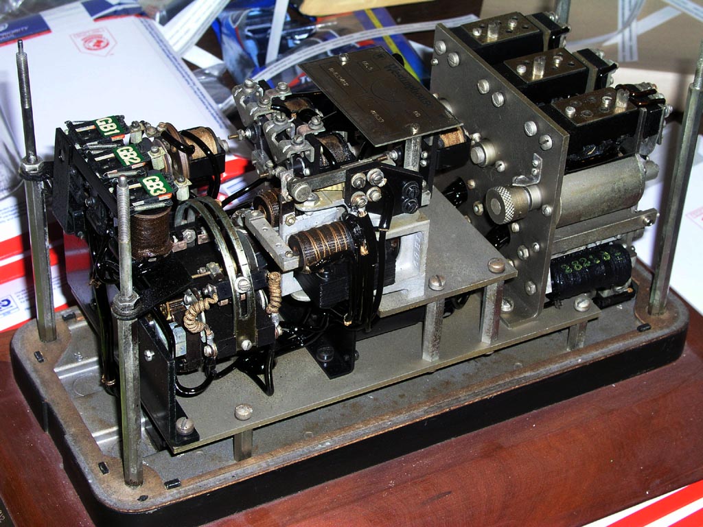

Then there's the second picture attached . . .
this piece of equipment is the size of a big
loaf of bread. It contains no electronics. Just
copper, Bakelite and steel. It contains 1 bit
comparators, analog-digital converters, etc. etc.
It's one of several controllers used to manage
a 1930's steam driven megawatt power plant.
The thought processes and talents that brought
your lathe into a practical reality are in the
same class.

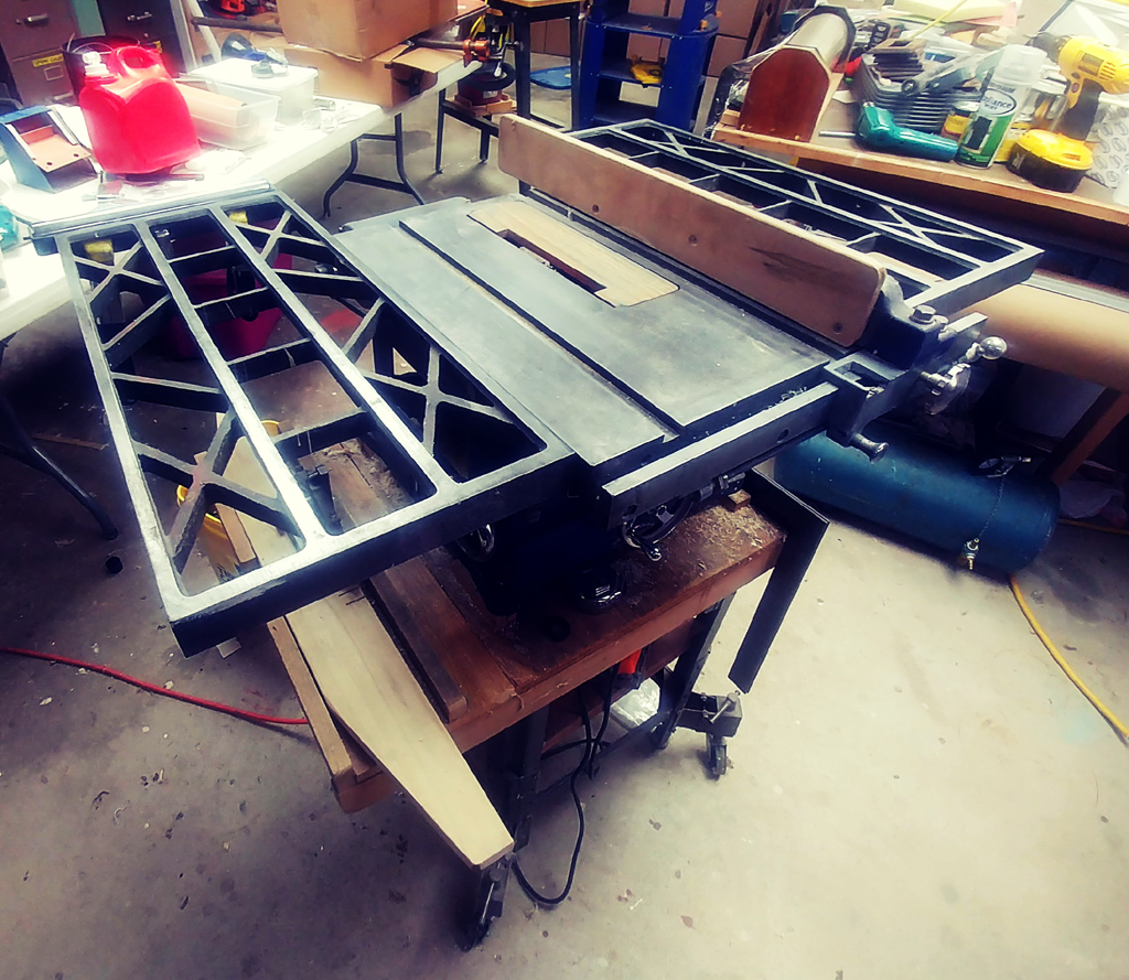

One of my prized possessions is a Craftsman table
saw of 1950 vintage. Belonged to my wife's
grandfather. When we did their estate sale
about 20 years ago, nobody would offer what
we thought the saw was worth. My father-
in-law 'willed' it to me.
I put it on a new base with casters. Upgraded
the motor. Added extensions to the table top. Next
enhancement is to facilitate long rips with
rollers added to the down-stream edge of the
extensions.
There's something really satisfying to exploit
the utility of a tool that's nearly as old as
I am!
