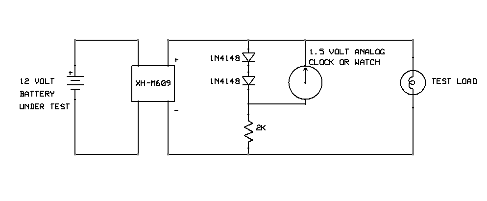

user9253
Joined: 28 Mar 2008
Posts: 1978
Location: Riley TWP Michigan
PostPosted: Wed Feb 03, 2021 1:41 pm    Post subject: Re: Poor Man's Battery Tester Reply with quote
XH-M609 Battery Low Voltage Disconnect Module is available on eBay for as little as $5.
Let me know if there is an error in my circuit.

PostPosted: Sat Feb 06, 2021 9:32 am    Post subject: Poor Man's Battery Tester Reply with quote
Joe Gores
Looks good to me Joe. You could also use
two FORWARD biased diodes to get your ~1.5
Volt supply for the clock. Let us know how
this shakes out . . .

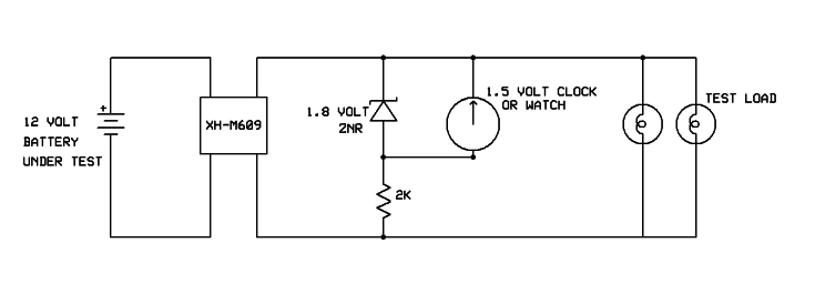

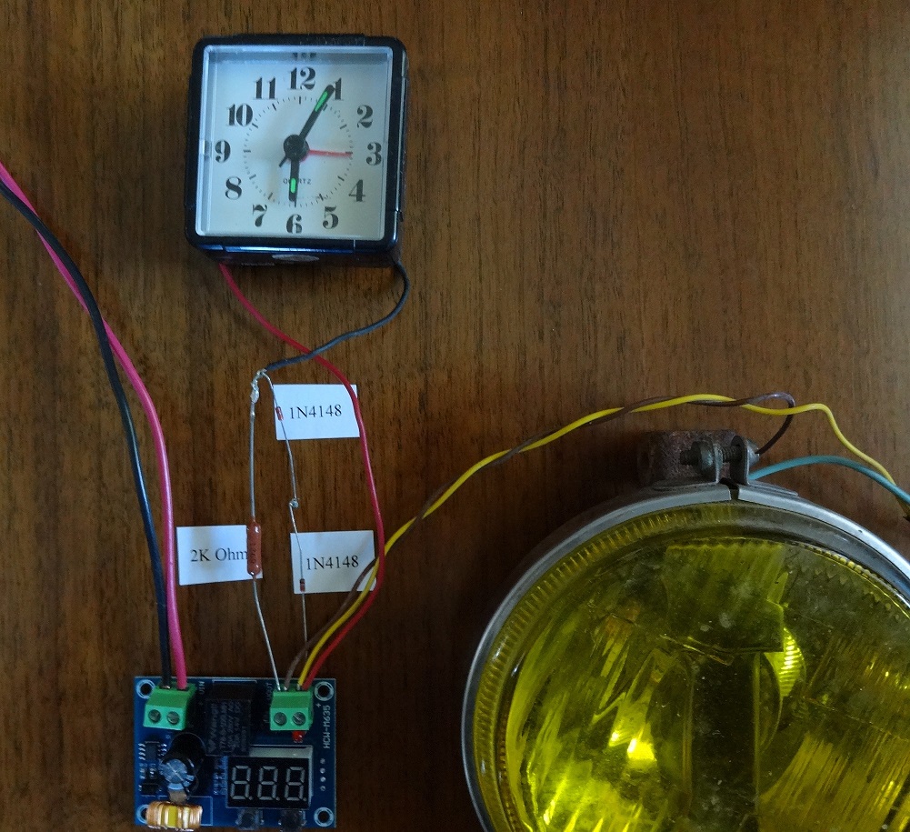

PostPosted: Fri Apr 02, 2021 1:32 pm    Post subject: Re: Poor Man's Battery Tester Reply with quote
XH-M609 Low voltage shut off
I purchased this module for about $5 on eBay from a seller in China. The relay is SPST.
The digital display is not steady but flickers or oscillates between a higher and lower digit. That is annoying.
The displayed voltage is 0.5 volts lower than the actual voltage.
The module did not come with any instructions. I learned how to use it via trial and error.
There are two things that need to be set, hysteresis and low voltage shut off.
Press and release the button on the right to see the hysteresis set-point.
To change the set-point, push the right button twice while the set-point is displayed.
The decimal point will flash, indicating that it is in set mode.
Press the buttons labeled + and – to raise or lower the hysteresis set-point.
I set mine at 1.5 volts. If set too high, the relay will not energize.
Don’t dawdle because the display will revert back to battery voltage after a few seconds.
Press and release the button on the left to see the low voltage shutoff set-point. To change the set-point,
push the left button twice while the set-point is displayed. The decimal point will flash, indicating it is in set mode.
Press the buttons labeled + and – to raise or lower the low voltage set-point.
I set mine at 10.5 volts which is actually 11 volts because the display is a half volt lower than the actual voltage.
As suggested by Bob, I used two series diodes (1N4148) in parallel with the clock to limit the clock
voltage to 1.5 volts. A 2K ohm series resistor limits diode and battery current to 50ma.
I did not want to damage the clock by soldering. So I cut a wooden dowel
to the same length as an AA battery. I installed this “wooden” battery into
the clock along with the clock power wires pinched between the wood and battery contacts.
Do not make the mistake that I did and use too small wires between the battery and XH-M609.
The relay chattered because too much voltage was dropped across the battery wires.
The XH-M609 saw low voltage and shut off the relay. With the load shut off, the voltage increased, the relay energized.
This repeated over and over. The relay sounded like a buzzer. I then used 14AWG wires and all was well.
The load that I used is an old automotive incandescent fog light.
With a battery connected to the test circuit, the clock ran for 70 minutes before it shut off.
Although the XH-M609 has its faults, it worked as intended to shut off the load when battery voltage dropped to 11 volts.
