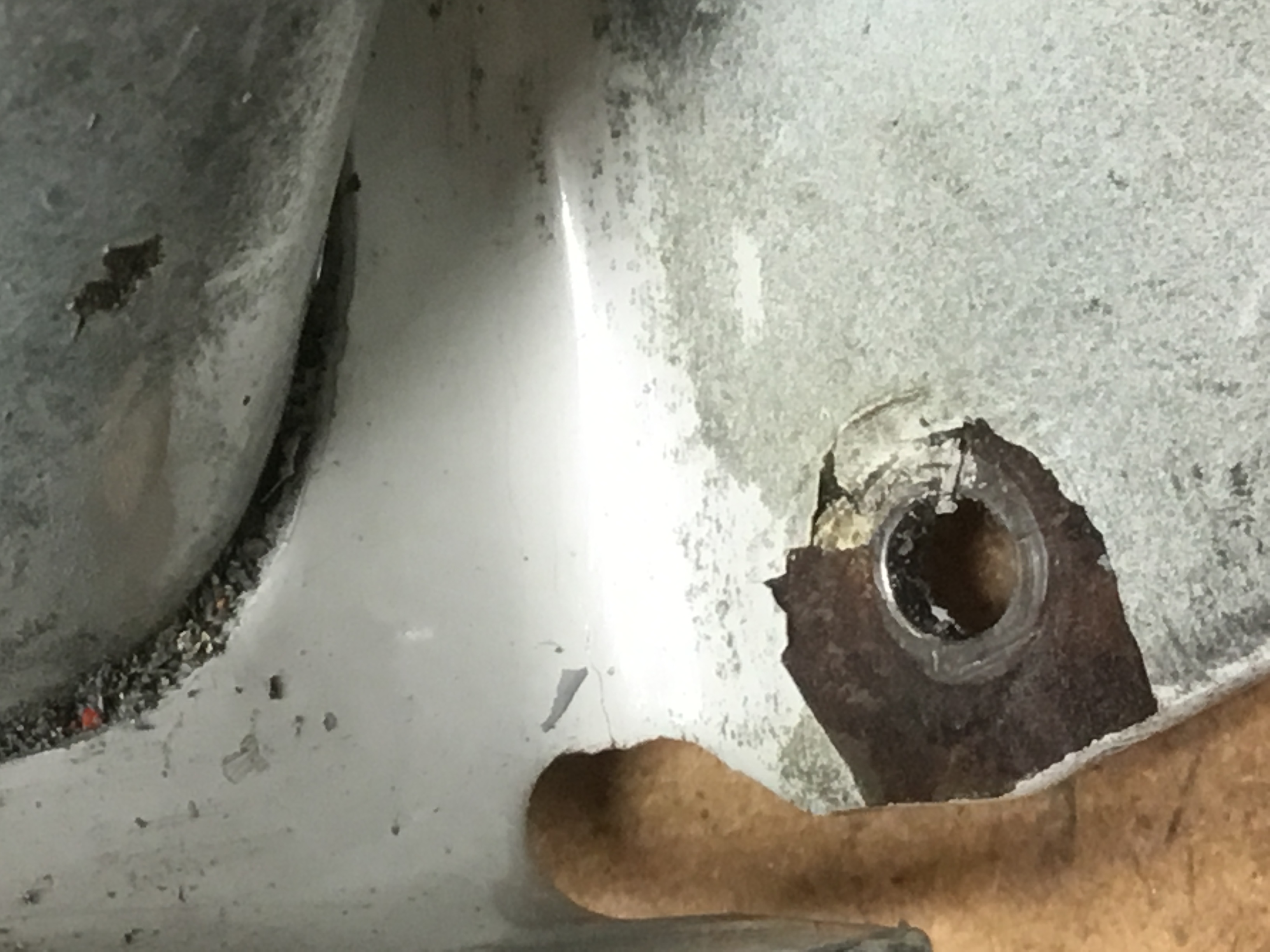

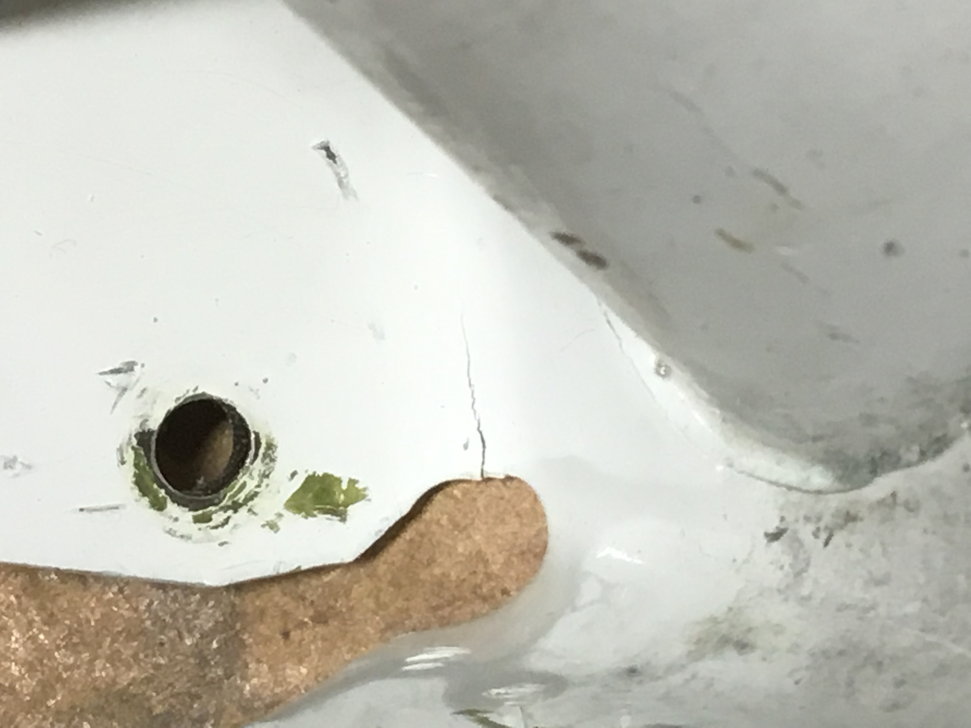

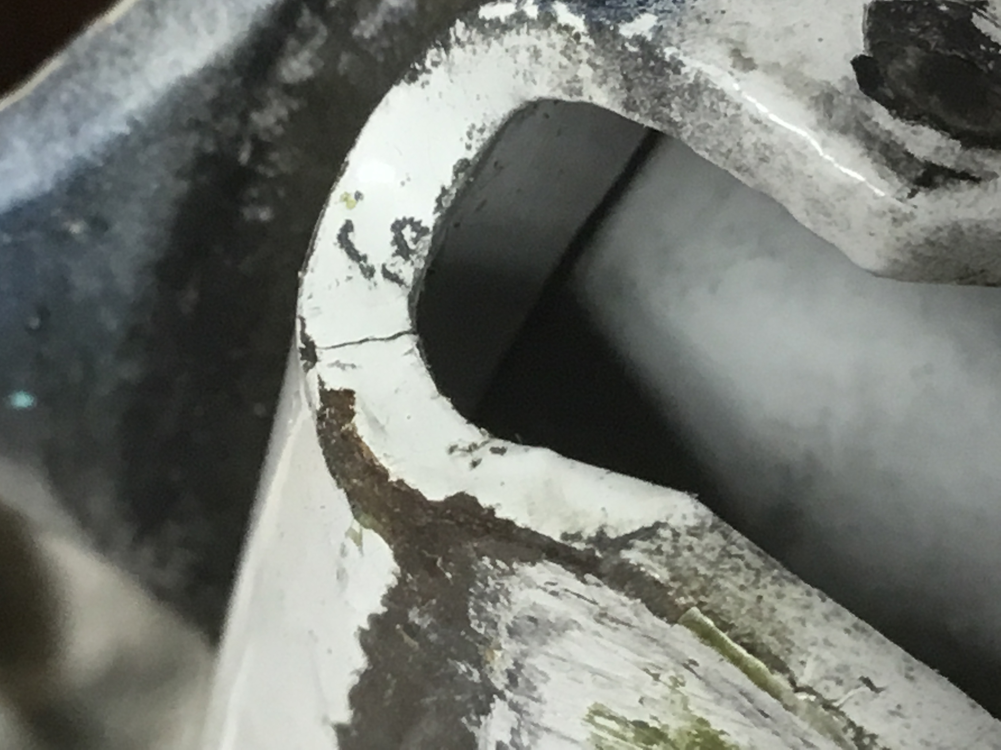

I think The new motor mount is like the 14. Where the cushions are, it’s not solid but swivel or rotates. So the arm from nose gear to cushion is completely different. Cannot use old with new. No spacers under cap it’s spring. I don’t have the info with me but that’s the jest. Replaced nose gear once and then they’re design it. Wallow out bolt holes cracks to look for I gave up ordered new upgrade kit.
Right now doing gear weldments both of mine cracked. As per SB. Not much fun.

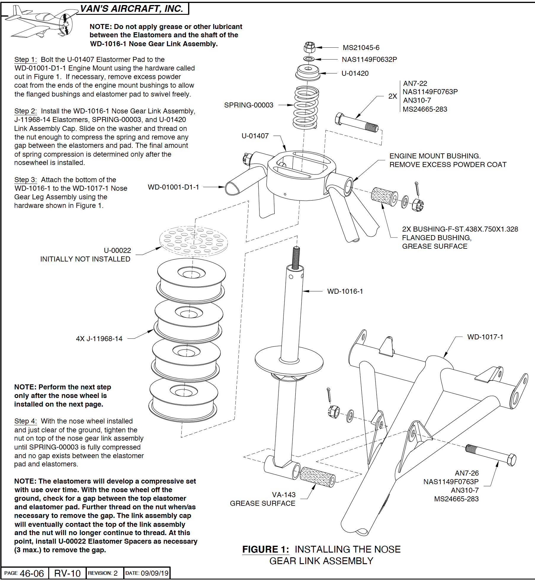

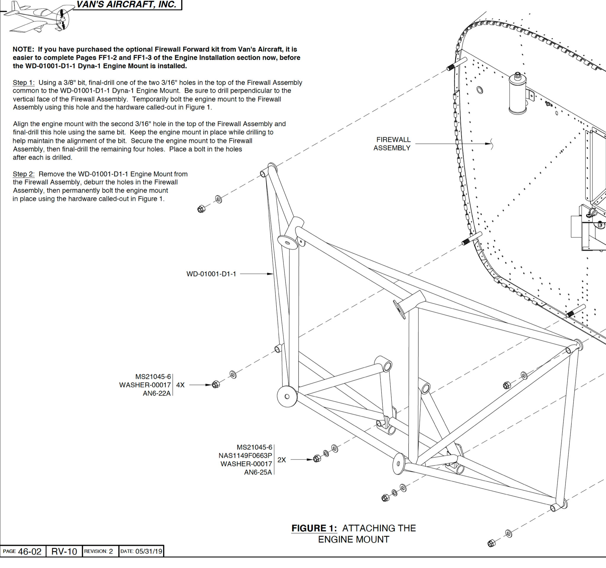

The new engine mount looks like this:
[img]cid:DC944129-431D-41D1-A849-461D756AAB95[/img]
[img]cid:E2F922E5-F4B7-4438-A0DE-496B7B8F4C72[/img]
Lenny

PostPosted: Fri Apr 02, 2021 7:10 am    Post subject: Another reality check Reply with quote
Yes, as I said to Patrick in a private email, once it was pointed out on
the revised plans, the change to the nose gear attach is obvious, but
Vans does not have anything on their support web page, no change
description, no SB, no nothing. We only have the SB on the attach at the
bottom of the mount, which is a change to the nose gear itself. As well
as the SB for the nose gear donut mounting plate from several years
back. Wonder if the new engine mount and shock disk mount has benefits
Lenny
> On Apr 2, 2021, at 9:55 AM, Don McDonald <building_partner(at)yahoo.com
> <mailto:building_partner(at)yahoo.com>> wrote:
> Patrick,just curious, what prop are you running?
> On Friday, April 2, 2021, 02:00:30 AM CDT, Patrick Thyssen
> much fun.

Interesting. I had no idea. That's exactly like my RV-14.
There are things I like about it, but, it is a noisy system on bumpy
taxiways.

The new engine mount has had a major change where the nose gear attaches to it. Look at the new parts on Vans website. It is quite different.

Changed in what way? Just curious, as can find no mention of it.
All of the SB on nose gear involve parts not on the mount. I just finished reviewing every service bulletin as part of my condition inspection. Maybe there are improvements, but none are reflected in SBs. I see the part number has had a -1 added, but see no information about what is actually different. Would love to know what, when, why.
Kelly

I suspect there is not any real problem with the older design after the donut mounting plate was added. I think that the change may have been to lower total parts across the fleet by using some parts from the RV14 so that they were the same. They used an inappropriate nose wheel on the 10 because they had it in stock. I used the Matco wheels and brakes and the Matco front axle.
I think Van’s does a very good job with their designs. They are great performers and quite stout. They are easily up to the job. However there is always room for improvement at a cost. I have a pile of after market improvements on my 10. Particularly the doors and firewall forward. I am not sorry about any of those choices despite the extra work and expense. My doors are stiff and reliably close snugly. I have a Barrett 540-X that puts out 290 hp with a Showplanes cowl and a Whirlwind carbon fiber prop. Cooling is adequate when it is 110F in the desert.
I have no complaint on my 10 nose gear so far, but I only have 150 hours and a little over 150 landings so far. I only land on grass at M99 when I am visiting one of my brothers who own it. He keeps it really smooth and I don’t think it puts any extra wear and tear on anything.
Robert Jones
On Apr 3, 2021, at 12:37 PM, Kelly McMullen <kellym(at)aviating.com> wrote:
Yes, as I said to Patrick in a private email, once it was pointed out on the revised plans, the change to the nose gear attach is obvious, but Vans does not have anything on their support web page, no change description, no SB, no nothing. We only have the SB on the attach at the bottom of the mount, which is a change to the nose gear itself. As well as the SB for the nose gear donut mounting plate from several years back. Wonder if the new engine mount and shock disk mount has benefits to those of us that only operate off paved runways (not to mention making greaser landings like all RV pilots 8^)). Perhaps reduce potential for nose gear shimmy? I see Van's finally addressed the nose wheel bearing torque issue that the early builders pointed out in time for later builders, to get the Matco axle or other axle that allowed torquing regardless of how tight the axle bolt is.
