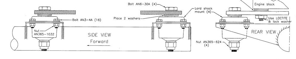

Still thinking about upgrading my Kolb MKIII, planning to go from a 68" Ivo to a 72" Warp Drive prop, will need to raise the engine so the prop will clear the boom tube.
The attached picture shows the typical / normal Lord shock mount method of attachment between the airframe and the motor mount plate.
One easy way to gain more prop clearance is to flip the Lord mounts over, they are 1" taller one way than the other, but I have never seen anybody do that.
Is there a reason why this is not a good idea?

Richard,
I turned my mounts with the high side up. I found that it is critical to use large snubbing washers on the bottom side of the mounts to prevent over stressing the rubber part of the mount, especially so on the rear mounts which experience high tensile stress under full thrust.

I have also heard of guys only turning the rear mounts over and leaving fronts in lower position when going with larger prop for clearance. Was told it will give you a little more clearance for prop against boom and lessens the "nose over" effect at full power when getting the thrust line too high. Havent done it myself.

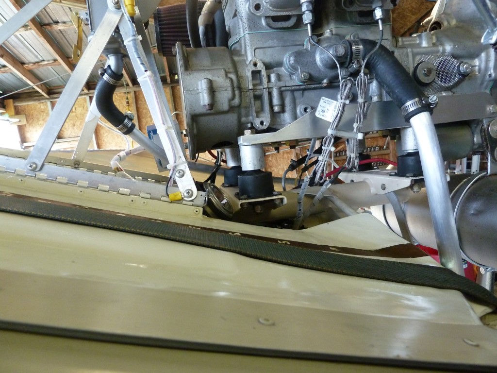

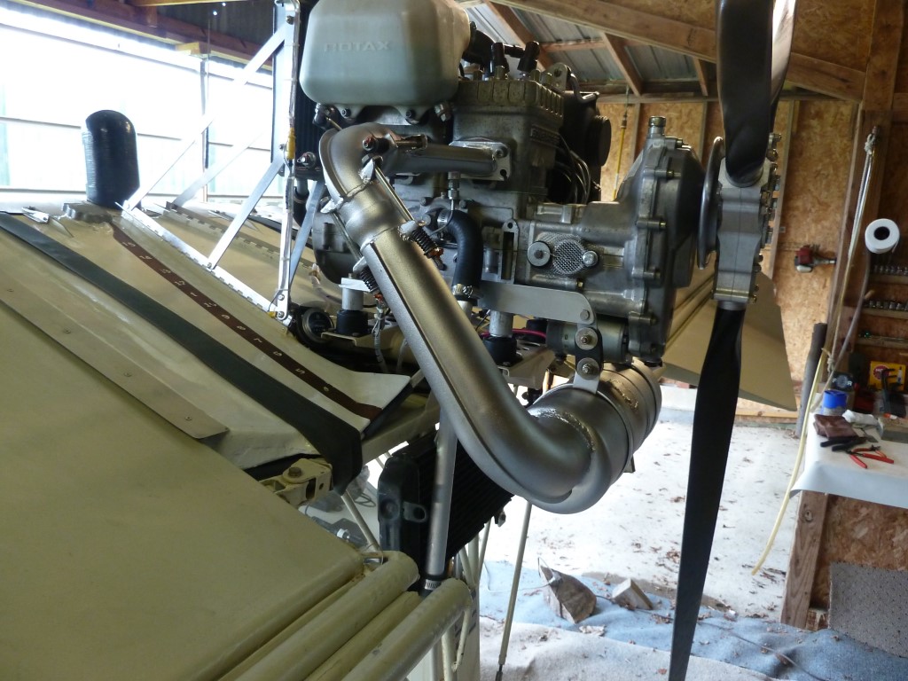

I did end up flipping the motor mounts over, plus the original spacers, and also added two extra washers to the rear mounts to get the required 1" of clearance from the tail boom. Once everything was installed, I hung all my body weight onto the prop hub and the prop tip still had about a 1/2" clearance, so that's good.
It is now a lot trickier to take off, you can't just cob the throttle and go like previously, it now wants to yaw hard to the right if you try that. You have to keep the tail planted firmly on the ground and use partial throttle until the airspeed gets to 30 and the rudder becomes fully effective, then raise the tail and go to full throttle. In cruise the ball wants to be 1/2 out to the left, will need a bigger rudder trim tab.
Rate of climb is better by about 300'-400'/min, very pleased at the smoothness and that it is quieter, but getting the 582 to be happy with this gearbox/prop combination was & is perplexing. For whatever reason, it has to be a lot leaner at cruise.
Idle jet is down from a 55 to a 50.
Needle clip position is supposed to be a 3, it is now a 1. This is with new needles.
RPM on climbout is 6350, EGT's at 950-1000.
Cruise is normally 5350-5400, airspeed around 65-70, EGT's 1050-1100.
If you throttle back to less than 5350, the engine falls off the pipe and the rpm will decay down to around 4600 and then stabilize at that rpm, with EGT's around 950.
As soon as you give it the least bit of throttle, then the rpm begins to rise, eventually stabilizing again at 5350, EGT's back to 1050-1100.
Ignition system was completely replaced last year, plugs are new, plug caps are new, EGT gauge and probes are new, jet needles and carb boots are new, choke pistons are new, air filter is clean.
It starts easily, runs smoothly and seems entirely reliable, the only other thing that is different than from before when it had the B box and the 68" Ivo is that I have not yet put the after-muffler back on it. That shouldn't make a difference but it is the only variable that has not been tested. It wasn't like this before, where ever you put the throttle back then, that is where it ran. I can live with it, but I'd like to get it resolved.

I just spent 4 hours flipping those dang lord mounts. No easy way to get to them. I put one additional washer between the lord mount and mounting plate at the rear. That will slightly increase the downward thrust angle. I have a 68” 3 blade Kool prop. Like a Luga. Very light weight. Hopefully next week I will be making some static thrust runs……
