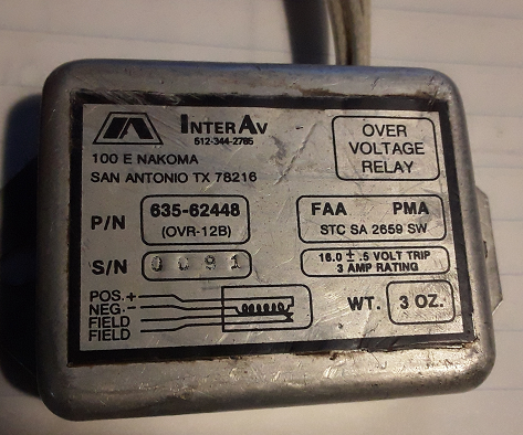

So I'm sitting with this interav OV regulator of unknown condition that I want to test.
It has all white leads, but it's fairly easy to pick up what appears to be the coil at 3 ohms and the contacts on the other two wires.
[img]cid:ii_kqfcys9w6[/img]
Now since I don't really know how these devices work, I'm looking for advice on how to test effectively.
Do these devices work/not work, or is there more to it?

Are the wires shorted together that you suspect are the contacts?
If not, maybe the 3 ohms are the contact wires. 3 ohms could be from corroded contacts.
3 ohms is too low for a coil. It would draw almost 5 amps and get very hot, 70 watts of heat.
Assuming the contacts are normally closed, then:
If one pair of wires is open, it means that either the contacts are not making contact or the coil is open.
In either case, the relay is defective.

Hi Bob,
Indeed, a potted version of the device so no salvageable knowledge there!
Appreciate the feedback; this is one for the bin!
