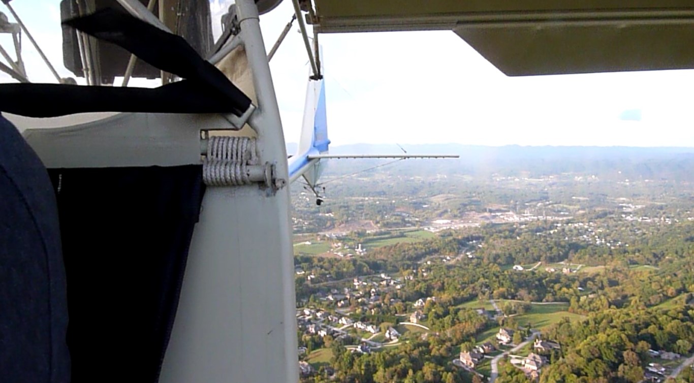

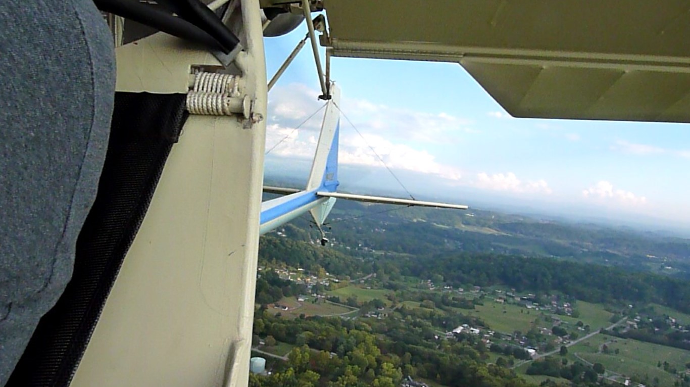

Flew yesterday evening and again tonight, perfect conditions, took some pictures, got my head on straight about my engine/gearbox/prop setup. Here's how:
Yesterday's flight I set out to film the horizontal stab/elevator at 5000, 52k, 54k, 56k, 58k, & 6k rpm.
The elevator at 5k & 5200 rpm was slightly down - 1st pic.
At 5600 - 6k it was in line - 2nd pic.
Thinking about the effect of going from the B box/electric starter & Ivo, to an E box w/electric starter & Warp Drive - I am thinking I moved about 5-7 pounds of weight rearward about 24".
So now - with moderate thrust at 5-5200 rpm, the slightly rearward CG requires drooping the elevators a hair, at higher speeds/more thrust, everything is about where it needs to be.
