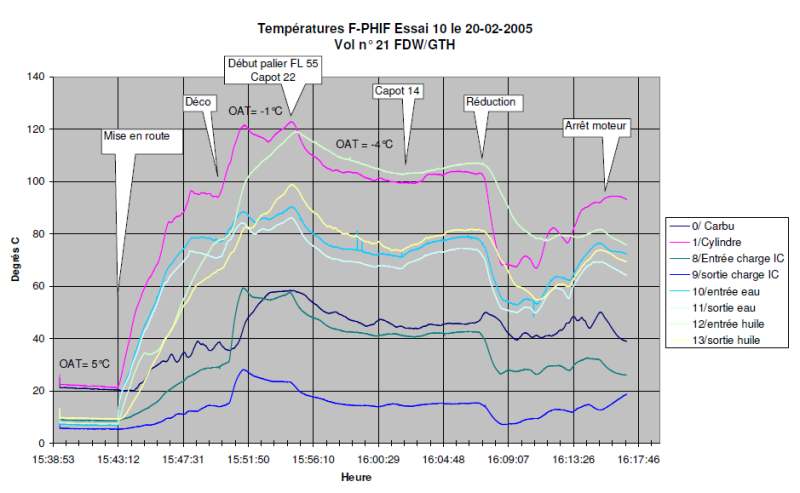

PostPosted: Mon Oct 25, 2021 12:55 am    Post subject: Rotax Cooling Air Baffle Reply with quote
Le 24/10/2021 à 19:04, rparigoris a écrit :
--> Europa-List message posted by: "rparigoris" <rparigor(at)hotmail.com> (rparigor(at)hotmail.com)
Hi Group Has anyone flying with Rotax Cooling Air Baffle modified the internal flow to give cylinders #3 and #4 a little more flow compared to the front two cylinders? How about with a 914 even giving #3 a little more flow compared to #4? This coming week going to test mine with a leaf blower. Thx. Ron
Hello Ron and all,
We installed the Rotax air baffle on our 914 and made some measurements at the time.
Here are some considerations :
With adequate sealing around the baffle and some pressure recovery (expanding inlet), all 4 cylinders get enough cooling air.
Only the #1 gets some extra blast from the "bizarre" Rotax inlet.
Due to liquid cooling, the cylinder heads are good "temperature sources" and the cylinder temps never exceeded 100/120 °C.
[img]cid:part1.B6BB1D9E.6AD7895F(at)free.fr[/img]
FWIW, --
Best regards
Gilles
http://contrails.free.fr
http://lapierre.skunkworks.free.fr
 Filesize:  44.17 KB
 Viewed:  6587 Time(s)
Best regards,
Gilles
