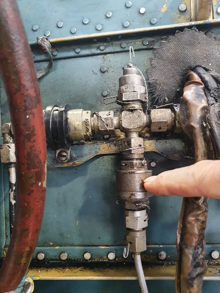

PostPosted: Mon Nov 29, 2021 5:15 am    Post subject: Re: Compressor troubleshooting before replacing Reply with quote
Our Yak-52 has a fine gauze strainer off the four-way union where the compressor output goes into the aircraft. It is opposite the pop-off valve in the main line to the air bottles. I took ours apart for the first time (maybe ever!) and it was full of nastiness.
 Filesize:  331.74 KB
 Viewed:  10777 Time(s)

True, but self correcting IF your are paying attention
dsavarese0812(at)bellsout
PostPosted: Mon Nov 29, 2021 5:37 pm    Post subject: Compressor troubleshooting before replacing Reply with quote
The "filter" you are speaking of is totally junk.  It's useless. Might
as well not even have one like that on the airplane.
A. Dennis Savarese
334-546-8182
www.yak-52.comTha
http://forums.matronics.com/viewtopic.php?p=504976#504976
http://forums.matronics.com//files/air_system_gauze_151.jpg
PostPosted: Mon Nov 29, 2021 5:38 pm    Post subject: Compressor troubleshooting before replacing Reply with quote

When was the last time you removed the snot bottle from the firewall and
cleaned and flushed it completely with avgas out of all three orifices?
You'll be amazed how much junk you'll get out of it.  See if that
doesn't help.

If you do clean the valve as Greg suggested, be sure to use all new
crush washers when reinstalling.
Dennis

You're right.  But testing with the glove finger will give you a pretty
good idea of whether the compressor is pumping air or not.
I agree Dennis but I didn't call it a filter, that is way overstating its effectiveness. Nor did I suggest it was any good at its job, I merely meant it is a potential blockage point - as I found for myself.
PostPosted: Tue Nov 30, 2021 5:34 am    Post subject: Compressor troubleshooting before replacing Reply with quote
I know you didn't call it a filter. I did, in quotes. Being sarcastic. That so called filter should have been placed at the external air fill port to trap junk that might be injected into the air system before it goes to the emergency and main air system.
In it's present position, just below the pressure relief valve, junk that is forced into the air system when filling from the external air fill port has to pass through 2 check valves, which is ridiculous because many times that junk causes one or both of those two check valves to leak. If the junk were captured before it ever got to the check valves, there would be less check valve failures.
The type of air filter that should be installed below the pressure relief valve is one that has screens, felt filters and desiccant to remove moisture from the system. Just like the one Doug Sapp sold for the CJ's and was adapted to the Yak 52's by placing it in same position as the original "filter". Now THAT was a filter!
Dennis
