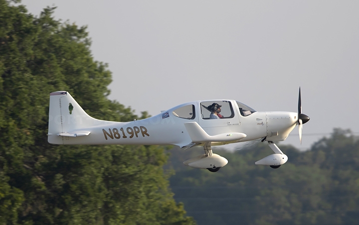

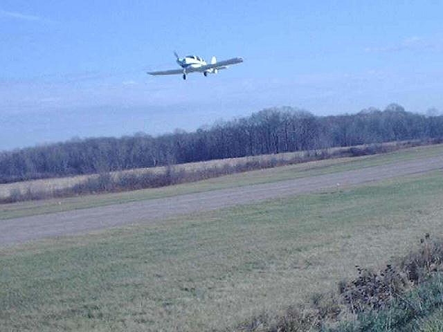

As of 12/03/2021, my KIS4 airplane (SN 4052) has been flying for 20 years. Originally built by Dave Tate as N92DT it has averaged 75 flight hours every year since then. I hope to see it flying for at least another 20 years.
 Attached is a photo taken on 12/3/2021 during the 1st flight and a photo taken on 4/16/2021 during Sun-N-Fun.

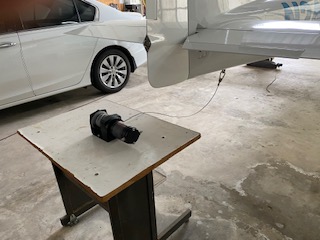

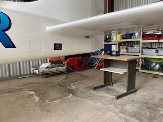

Hi Bob, I had the same problem with my hangar approach so I made a KIS tug. I installed a  single 3/8” anchor in the hangar floor at about 2/3rds of the hangar depth and in line with the fuselage centerline. I bent a loop out of some flat iron that bolts to the anchor. This is for a winch cable hook. I bought a cheap 12 volt remote controlled winch from Harbor freight. I mounted the winch and a battery to an angle iron frame I fabricated that allows the angles to spread and two studs to engage in the tow bar holes on the nose wheel when aligned from the rear. I put two old lawn mower wheels on the rear of the frame. I put some foam pipe insulation over the angle irons where they are near the wheel pant to avoid any contact. I have a small tie angle on the front of the setup that you swing close and drop in a ¼’ locking bolt after you engage the studs in nose wheel. I’ve found putting a pipe wrench on the tie angle helps to steer the nose wheel into the hangar. Makes life a lot easier for us especially when we are full of fuel. I keep an old cable come-a-long in the hangar in case the battery gets low.

BobI also used a cheap Harbor freight winch to pull my plane back into the hanger. Looped a soft nylon rope around the horizontal stab, then could use the remote control on the winch while guiding from the front with a towbar.

Bob, I will be at my hangar next Monday. I will take a picture of my setup. Simply put, mine is a tow bar that connects to the toe bar points on the nosewheel that has a an onboard winch, with a Bluetooth remote, that attaches to an anchor point in the hangar floor.

I am setting it up to use the tie down for the tail to pull and guide while I push and steer the nose with the tow bar. Got the stand firmly anchored to the floor, just need battery and testing.
Going to add a guide and stop to keep from pulling too far.

Interesting, but I have never been a fan of pulling the airplane by the tail tie down. Not sure it can handle the forces on it from an angle instead of straight down as it was designed.
Keep us updated on how it works and well it stands up to being pulled on this way.

Bill S, our builder specifically told us not to pull from the rear tie.
Down ok but not back. I guess it could be dependant on how it was installed
during build.

First is that I won’t be using the winch to pull alone but to assist me on the pushing with the tow bar and help guide the tail into position.
Second, I would not have even considered using the tiedown if I had used the standard tie down. I designed a self-retracting tie down from u-channel mounted on a hard base and glassed in with multiple layers of glass. There’s some photos of it on my website. It should be equally or greater strength in lateral pull as down. I should know more by the end of this week.
Bob Reed

Yes, I was specific about not using the rear tail attachment to pull the plane in. The reason is that applies a rotary torque to the hold-down, which can peel the fiberglass on the inside of the fuselage. My prefered method was to put a rope over one side of the HZ stab, go under the fuselage, and up over the other side of the HZ stab. The rope was then attached to the cable, and the forces were distributed over a large area of very strong construction.Bill Schertz

Ed Hanson, I would like to see a photo of your setup, it sounds entirely different from what I am doing and I would like to see how you worked it.  Not sure if I understood that you are pulling back using the nose wheel or not.  If so, how do you steer the plane when it is backing up?
