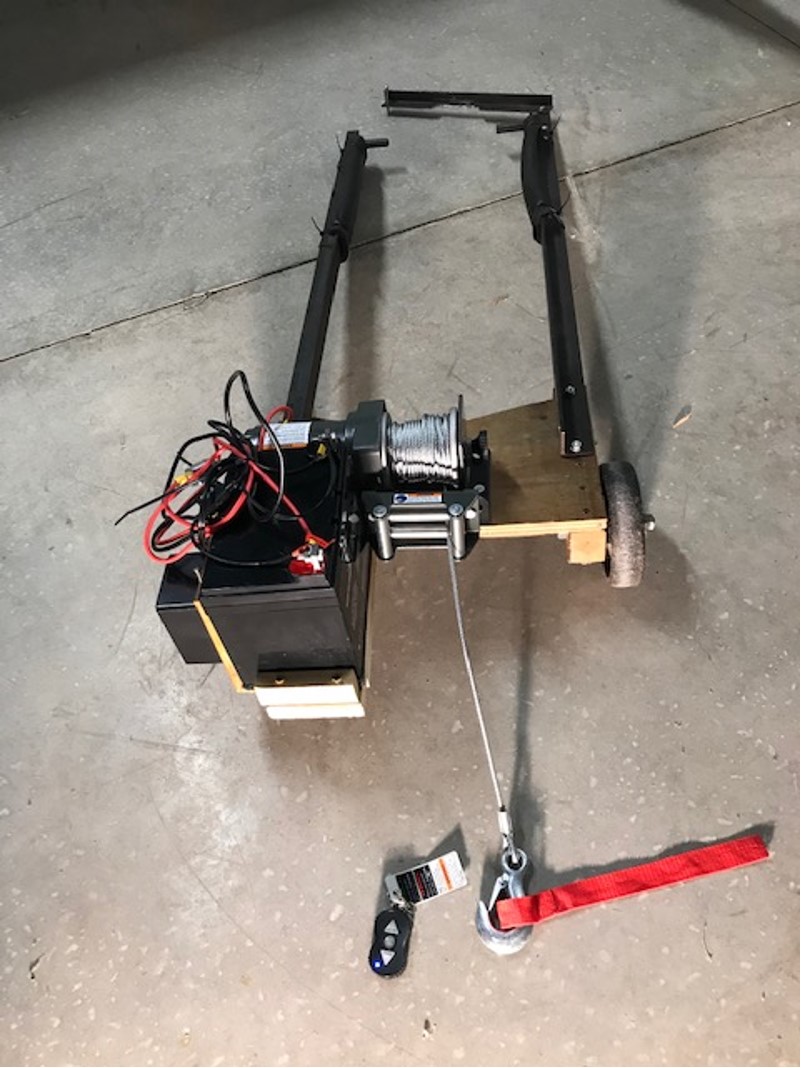

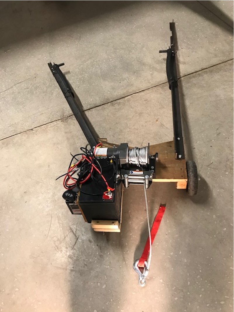

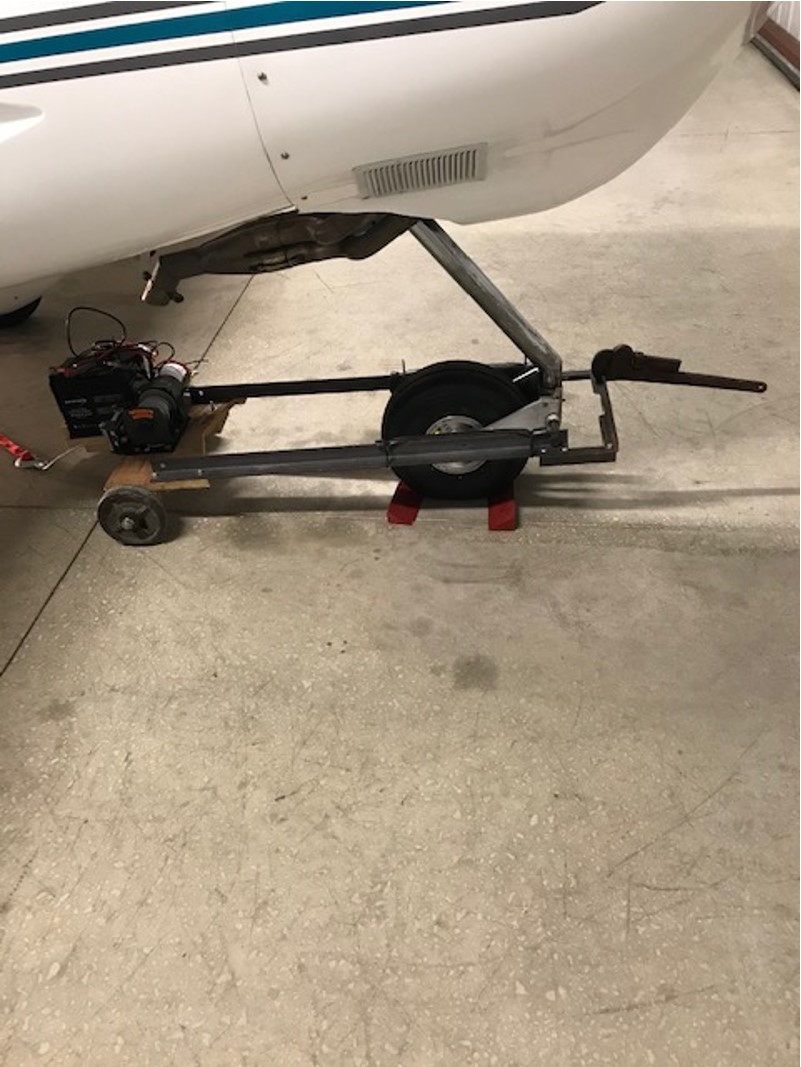

Stopped by the hangar tonight and took some pictures of my winch tug. I back the aircraft close to the proper position with my tow bar then winch it up the incline and 2” hangar lip into the hangar. I use the pipe wrench to add a little steering pressure if needed. The handheld winch remote allows good control. Sometimes we just can’t push it in ourselves and need a little tug help. I have the wheel pant off for some work but the tug is made to clear it.
