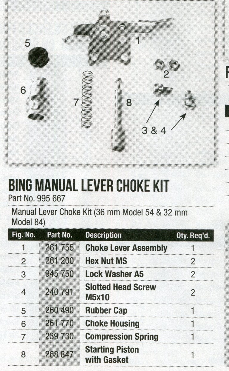

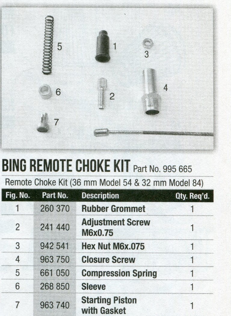

There are two types of chokes, one uses the lever and the plunger and the other type uses a remote cable with a clip-on sealer end. Both work on the same principle of opening a bypass circuit to let in extra fuel. (So really they are not chokes at all, but enrichment circuits)
Attached are two pictures, hopefully they are good enough to be self explanatory. Something I just noticed: the cable end in the attached picture is enormous, and must have just been put there for - something. The actual cable end that fits into piston 7 is WAY smaller and will fit down through the adjuster.
Something we learned last year with the 277 on the Firefly: there is a 3/32" thick rubber flat surface on the part that seals up against the brass opening for the bypass. (the "gasket") Part #7 on the remote system, part #8 on the lever system.
Over time, that rubber can get worn out or damaged, and then it no longer seals, which means you are now dumping extra fuel in at all throttle settings. Which makes it impossible to get the engine to jet properly. Once I found the problem it was an easy fix: grub out the old rubber and grind a sharp edge on the end of a piece of metal tubing the same diameter as the piston, punch a piece of rubber out of any suitably thick rubber scrap and force it into place in the end of the piston. All it has to do is allow/stop fuel flow.
As far as how you actually rig it; the nut 3 screws on the adjuster 2, screw the adjuster into closure 4. Stick the cable through the rubber 1, and down through the adjuster and out through the closure, slide the spring over the cable, then the cable goes through sleeve 6, and then hook the end of the cable into the slot in piston 7. Let the spring snap the sleeve down into place around piston 7 and it will hold the cable in the piston. Adjusted correctly, actuating the cable will raise the piston & open the fuel bypass in the carb.
 Filesize:  364.8 KB
 Viewed:  12975 Time(s)

PostPosted: Mon Jan 16, 2023 11:35 am    Post subject: Re: Bing 54 Reply with quote
First a description of how an en
richer works and then what I fear is a functional drawback when applied to our aircraft.
A true choke mechanically restricts air flow into the venturi. This method is somewhat tolerant of various throttle settings.
The enricher is a completely independent circuit which relies on high vacuum ahead of the slide to pull fuel up from the float bowl where it exits ahead of the slide. It takes a very small rise of the slide to destroy the necessary vacuum and defeat the enricher circuit. I ran into this repeatedly as a motorcycle snowmobile mechanic. Customer would state that their new machine was wonderful with the exception that it would not start cold. I would say lets go give it a try, as I watched they would inadvertently open the throttle just by the smallest amount, this resulted in a no start. I would then tell them to take their hand completely away from the throttle and use one finger to push the starter button, instant start. Sooo my concern with these engines pressed into service as aircraft power plants is that we need to run a fairly high slide position to eliminate gearbox chatter. I really doubt the universal effectiveness of enrichers, Like many snowmobiles I installed a pump type primer on my Firefly and disabled the enricher. Very effective and easy starts. Just position the primer within easy reach as it will require an additional pump or three as the engine warms.
