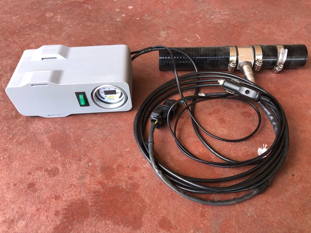

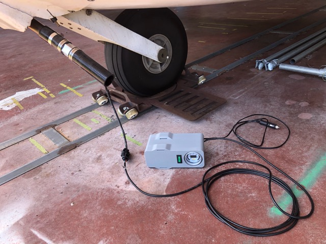

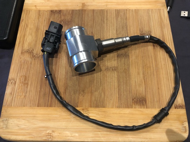

Checking O2 levels without drilling holes in exhaust systems; see pics... That's how its done.
Strap the tail wheel securely to a pole or pickup truck's tow hitch and run WOT at engine operating temps.
I've had my 80hp idle smooth at 600rpm while setting idle mixtures and balancing carbis.. the 100hp will probably tick over nicely at 1000rpm without a fuss during tuning... Anything below 500rpm on either spec engine will see the ignition modules shut down.
Once tuning is set it won't have any reason to alter; check it at each 100hr or annual if desired.
1/2 a turn on the idle mixture screw is still fairly broad; 1/8 turn adjustments between smooth and not smooth indicates you have reached optimum... For resetting idle mixture position screw all the way in until lightly stops then 1 1/2 turns out.... lift each carbi piston 1/2" momentarily while idling; the one that speeds up idling slightly is the richer one.
Don't walk into the moving propeller; it will hurt...

Chris, the setup i just bought the bits off fleabay and made one; the case is 3D printed in PETG with two velcro securing straps and the T'piece for the sensor i had to custom drill and tap to suit... i can make more units ready to use out of the box, and they would be around $600 Aud plus postage; the unit can be used in the cockpit during flight testing for specific altitudes tests also and has self contained battery power or plug into 12v supply and recharging. The tail pipe fitting length negates proximity contamination to external atmospheric air and fits 36mm - 40mm tail pipe sizes with provision for safety cable attachment should the T'piece depart during flight.
Balancing carbis at 3500/4000 etc is fine however its a lazy way of going about it and will only offer Intermediate range tuning, so that would be needle height adjustment only. Adjusting mixtures and butterflies for smooth idle are best achieved at the lowest possible rpm (operational idle rpm is set afterward); have had triple SU Aston Martin DB3's happily idling at 150rpm while setting mixtures... SU and Stromberg CV tuning method would be the most appropriate applied approach for Bing64 series. The only other point to note is symmetry of needle height position; if they are not the same height on each carbi and your tuning is complete then you have an issue remaining either an air leak, high or low float level, or unbalanced butterfly valves; take everything back to default and start again to find the reason for rich or lean side.
