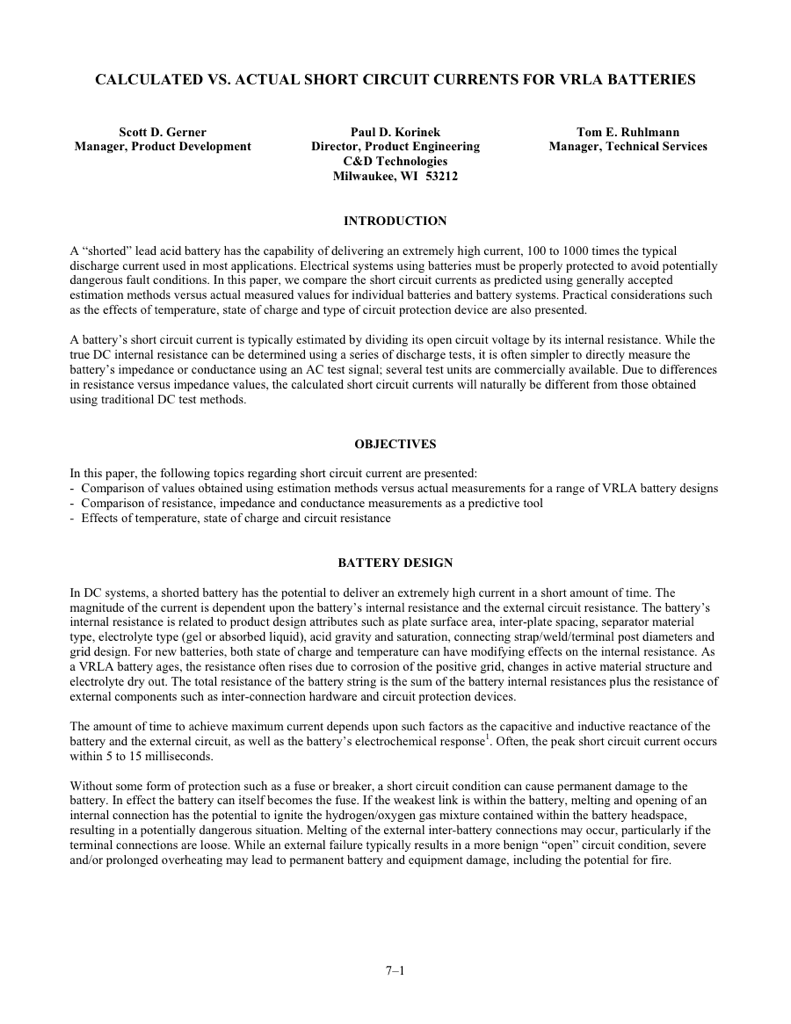

I agree that the likelihood of a direct short of a main battery cable is small. However, it is not zero and the localized heating from such a short could ignite combustibles. As long as the cable is kept away from combustibles, this isn’t an issue.
The difference in current between starting and a significant short is pretty large so viable overcurrent protection is feasible. For example, most engines in EA-B aircraft probably draw 100 amps or less during starting. It takes a fairly large engine to draw 200 amps (think diesel pickup truck or larger). Yes, the initial current when the starter is not turning can be twice or more the normal cranking current, but that is very short duration and is not likely to blow/trip a 200 A fuse or breaker. A short circuit of a battery can easily draw 1000 amps or more which would blow a 200 A fuse fairly quickly.
[img]cid:E2577D00-CEE6-44B3-963B-7FE9316010E4[/img]VRLAshortCurrentsStorageBatterySystems
PDF Document · 163 KB

I believe overcurrent protection on a battery is easily accomplished, but I tend to agree with Bob that the likelihood of needing this is small. Then again, you can make a similar argument for the battery contactor. You don’t see these in the automobile world as they are deemed unnecessary and for good reason. One could argue the same for aircraft.
