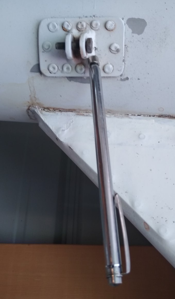

PostPosted: Wed Sep 06, 2023 6:45 am    Post subject: Older Firestarter hinges Reply with quote
I did just check, if it's the part I'm thinking of, it is steel. See the photo attached. A magnet hangs onto it.
