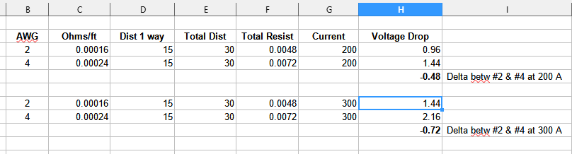

The 15 feet is one way, therefore it is actually 30 feet round trip, which doubles your numbers to .48 volts more drop using #4.
You used 200A. Is that typical starter current? I typically use 250A. Is 200A a more accurate assumption? In this aircraft we will be cranking a brand new IO-390.
I updated your calcs and did it for both 200 & 300 amps:
[img]cid:55a11853-6c86-90d7-e945-22e77f777669(at)yahoo.com[/img]">
The scenario in question is as follows:
1. You have attempted to start a flooded or cold engine and exhausted the primary starting battery on the firewall.
2. Now, you can engage the "back-up" battery for cranking. (with a paralleling solenoid that is designed into the system)
Is the .72 volts significant is this case?
Battery voltage during typical cranking is ~8.5 volts --- that's more of a question 'cuz I don't know for sure.
But, if that is correct then .72/8.5 = 6% at 300A. Is that significant in this scenario?
Seems like we are pretty far down the rabbit hole... Wink
-Jeff
You're not using the airframe as a ground return?
It's a wag driven by numerous variables
of temperature, engine condition, etc.
The purpose of the study was to illustrate
the DIFFERENCE between the two conductors in
a constant condition.
If you constantly used both batteries to crank,
then they will share the load and current in
the rear battery path will be less than 1/2
of total due to the longer conductor.
