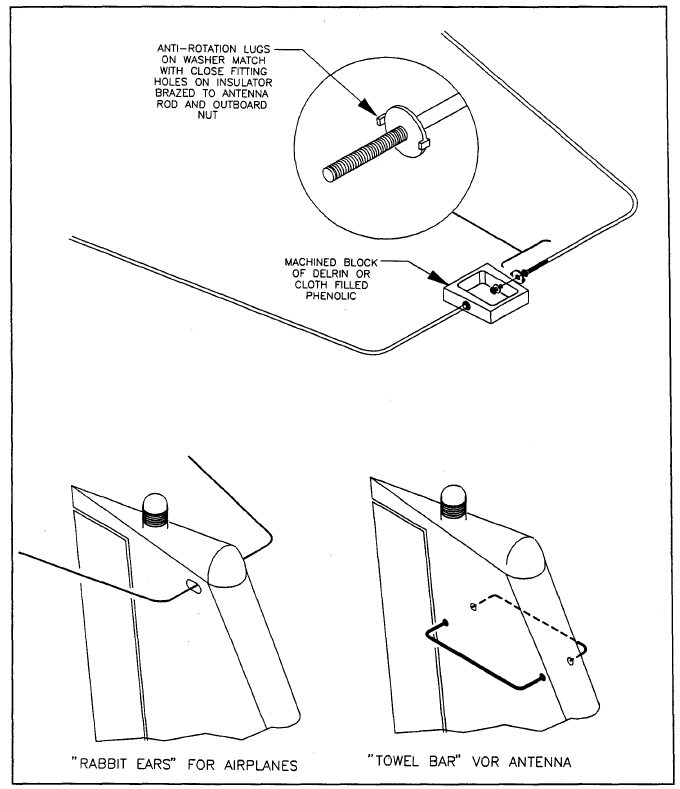

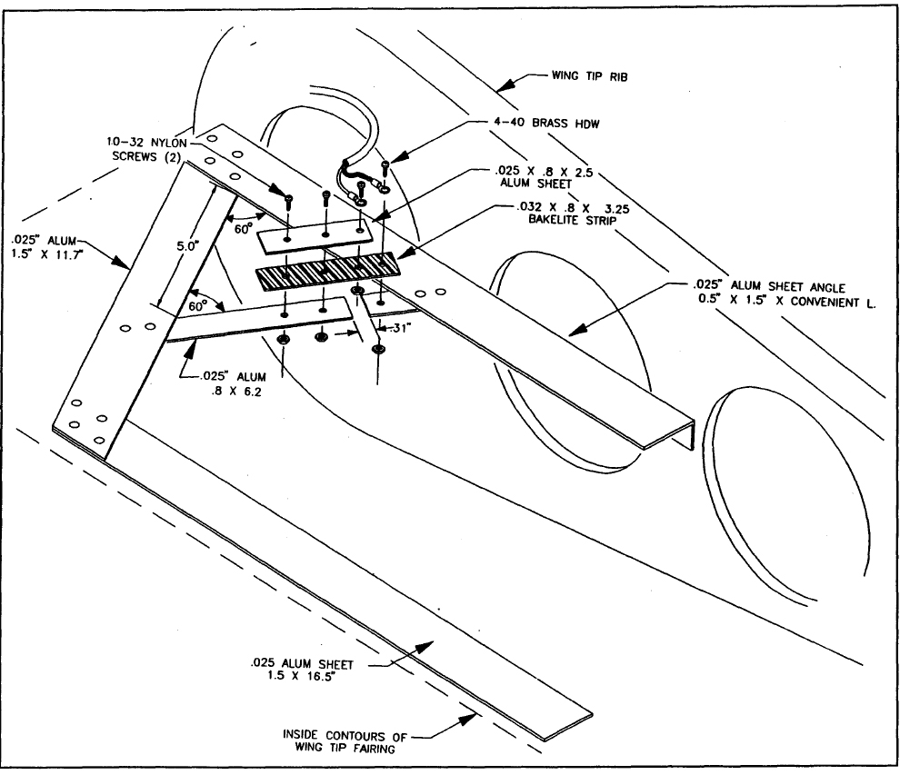

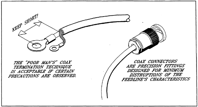

Consider the attached drawings that illustrate variations in
coax cable terminations. In Figure 1, we see two techniques
commonly found in countless production aircraft. (a) crimp
some terminals on the ends of the conductors and (b) install
a righteous coax connector. In Figure 2 we see one of Bob
Archer's famous, wing-tip VOR antennas tailored to RV
aircraft. Note that it features crude coax termination as in 1(A).
However, Bob's design also features a matching section
intended to optimize impedance matching between the antenna
and feedline. In Figure 3, we see a VOR antenna that was used
on hundreds of thousands of aircraft for decades. It too uses
terminals-on-conductors ('bumpy') and no attempt to optimize
impedance matching or correct for conditions posed by
connecting an 'unbalanced' feedline (coax) directly to
a 'balanced' antenna (dipole).
Hmmmm . . . if one scans these two antennas with a network
analyzer or time domain reflectometer, I suspect that the
Archer antenna would present 'nicer' characteristics
than the legacy 'rabbit ears' used for a century or so.
However, in terms of practical performance, it would not
surprise me to discover that the whiskers outperform
the wing-tip antenna in terms of receiver sensitivity
as measured in a circle around the airplane.
Now, does that bode ill for Mr. Archer's brainchild?
I suspect not . . . there are many examples flying
today. We're not hearing/reading of operator-owners
replacing them with 'something better'.
I cite this as one of countless examples of variations
in performance among similar systems. The market-place
question is, does Bob's antenna perform adequately to
the pilot's needs? The answer to that must be 'yes'.
This in spite of theoretical anomalies (like a 'bumpy'
coax termination) having no demonstrable shortcoming in practice.
