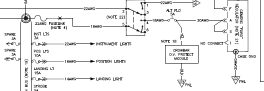

Hi Jeff,
 The book describes how to protect that feeder, using a 'fusible link' that you can fabricate. The fusible link will be more reliable than any separate device, and virtually free to make. You can use 22AWG wire as the link, with one end on the supply post to the fuseblock and  soldered or crimped to 18AWG wire which continues to the CB. You can sleeve the 22AWG with the fiberglass sleeving sold by B&C, or do what I did and sleeve it with regular silicone tubing. A catastrophic fault (which is what we're protecting from) will almost instantly vaporize the 22AWG, and the silicone tubing easily contains it. 'Note 4' starts on page Z-7 of the book.
[img]cid:part1.oVN4agYs.vY54mesI(at)gmail.com[/img]

PostPosted: Tue Nov 14, 2023 8:59 am    Post subject: Fuse Upstream of Breaker Reply with quote
At 11:49 AM 11/13/2023, you wrote:
Listers,
I want to put a 5 amp breaker in the regulator circuit in a airplane that has a 12-fuse distribution panel. The breaker would be mounted in the instrument panel which is about 2-3 feet away from the fuse panel.
Per Charlie's suggestion and configurations
depicted in ALL the Z-figures, fusible linked
extension of the bus to the remote breaker
is recommended.

I like them because once they're fab'd, they're zero maintenance and virtually zero risk of failure/nuisance trip, and there are fewer failure points because there are fewer joints in the path. Any fault severe enough to 'trip' the link is going to make a far larger arc, and noise, and smoke puff, than the link itself will make. It's simple and cheap to test; that's what I did to verify the safety/effectiveness of using silicone tubing for the protective layer over the link.

scenario is a fusible link. Why is a fusible link better than a 4x fuse under these relatively low-current situations?
The fusible link is close cousin to the
ANL/MANL/MIDI current limiters. Much more
robust than a fuse but STILL quite capable
of protecting a feeder suffering a hard-fault.
That short chunk of wire from main bus to
the alternator field crowbar breaker is
an EXTENSION of the main bus. Protection
on a bus extension is tailored to protect
the conductor but expected to source one
or more, smaller feeders for ship's
accessories. The I(squared)T value for
the link is several times larger than
any downstream breaker/fuse.
