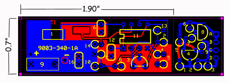

The attached figure is a snapshot of the present
configuration OVM-14 ECB. It's not terribly
larger than the legacy CBOVMs. I've not used
this assembly technique in more years than I

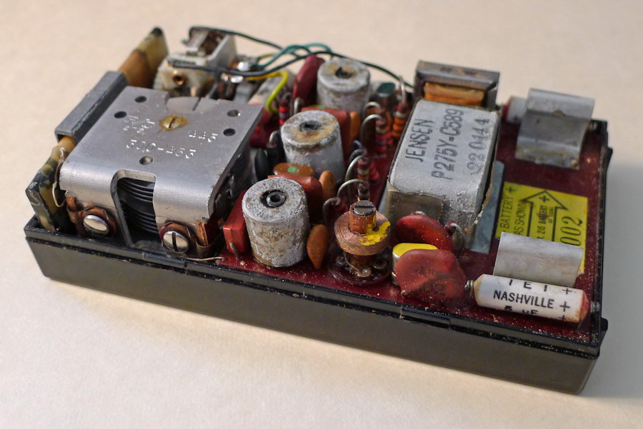

can recall . . . first observed it in the
fabrication of my first solid state pocket
radio. A Regency TR1 that cost me a pretty
penny in newspaper route earnings about 1958!
Note the resistors stand on end soldered into
pads with very close spacing. This offers
a tighter layout opportunity with another
benefit: The upper end of each resistor can
be oriented such that it attaches to an
interesting 'test node' on the board. An
oscilloscope or voltmeter probe can be clipped
to the lead wire for performance evaluation
and/or troubleshooting.

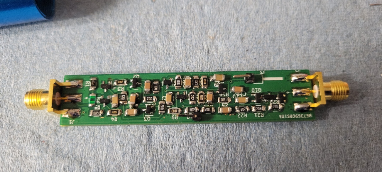

If you send me the schematic I can then make up a board with SMD and have it made by PCBway. They are very cost effective.
As an example the photo is an RF/audio probe I just finished using SMD. I used 1206 sized SMD for this.

Thank you so much for the offer sir. BTW, nice
looking assembly. SMA connectors? What does it do?

I've published the ECB layout and assy data at
https://tinyurl.com/ytdg9ehf
Any any assistance in proofing the layout to the
schematic would be appreciated. Will order boards
late tonight.

Bob, The unit displayed is an RF/audio probe for signal tracing. this feeds an amplifier. Yes, SMA connectors. It makes a nice compact unit using RG 174 as a lead. The probe is powered from the amp.

I looked at your layout and after finally figuring out the semantics it looks OK initially. It was confusing until I understood the numbering scheme for components.
For me it usually takes about 3 iterations to figure out what I forgot. At 82 I am finally recognizing a memory failure.

Boards are on order . . . stared at that last
iteration of the layout and finally succumbed
to an instance of 'creative destruction'. I've
re-laid the board to more conventional fabrication
philosophies. Yeah, it got a bit bigger but will
go together in minutes and 'look good'.
The assembly is now 2.2 x 0.7 inches and will
still 'house' nicely under a piece of heat
shrink.
Those interested in taking a peek can download
the proof prints at:
http://aeroelectric.com/DIY/OVM14%20mkII%20proof%20prints.pdf
The boards will be solder masked and silk screened
to facilitate kit-builders. Parts and boards will be
on hand for 15 prototypes next Thursday.

PostPosted: Mon Apr 07, 2025 6:32 pm    Post subject: Re: OVM-14 MkIII development (update) Reply with quote
There haven't been any updates on Bob's OVM-14 Mk III overvoltage protection module since Feb 2024 so I took a look at it to see what I could do. I found some minor things that might have been problems, so I made a few small changes:
1. Looking at the datasheet for the crowbar SCR... [https://tinyurl.com/yjvrdtfx] ...the specification for gate triggering current states that it could take as much as 15mA to trigger. As configured in the last schematic that Bob posted... [https://tinyurl.com/3jeddsky] ...with the gate drive resistor (R14) of 2.49k ohms connected to the bus, 15mA gate current would not be achieved until the overvoltage exceeded 37V.
CHANGE: R14 reduced to 620 ohms and connected to the 10V supply rail instead of the bus. This provides 16mA to trigger the SCR's gate, while preventing an overcurrent through the output of comparator U11.B (maximum 20mA).
2. At a bus voltage of 14V, current-limiting resistor R1 (392 ohms) would dissipate of about 1/3 watt, and would run hot.
CHANGE: R1 increased to 470 ohms and pass transistor Q17 added. This provides a sturdy 10V supply rail for the circuit, including adequate gate current to trigger the SCR. Continuous power dissipation in R1 will be reduced to 0.03W. At the high end of its 1% tolerance (475 ohms), with bus voltage at 12V, R1 will provide 3mA to U3 and the base of Q17, more than double the minimum required for regulation. At the low end of its tolerance (465 ohms), R1 will protect U3 against exceeding its absolute maximum current rating up to a ridiculous bus voltage of 81V.
3. The trip delay capacitor (C12) is a ceramic type, which may not be stable in a timing application due to the effects of DC bias, temperature and aging.
CHANGE: C12 changed to a 5% tolerance solid tantalum type.
With that done, I created a board layout that's very similar to Bob's and is the same size (0.7" x 2.2"). It still uses all through-hole parts except the SCR, which is large for a surface mount component and is relatively easy to hand solder. I moved the SCR to the top side of the board and added a 2-position 0.25" quick-connect terminal to make installation easy (wires can still be soldered directly to the board if preferred). I also changed to a "piano key" style DIP switch to activate the maintenance mode, which makes the switch accessible at the end of the assembly after heat shrink is applied.
After building a prototype, I found that the resistors that set the trip voltages didn't quite work as calculated, so I tweaked them experimentally to find the values that provide a normal trip at 16.0V (R8 = 2.61k) and a maintenance test mode trip at 13.7V (R10 = 69.8k). To ensure that maintenance test mode works correctly with all battery types, I bumped the test mode trip point up by 0.2V, from 13.5V to 13.7V. This will accommodate the higher resting voltage of a fully charged LiFePO4 battery (typically 3.4V per cell, or 13.6V for a 4-cell battery).
Finally, I assembled four additional prototypes and tested all five. In each case, the modules tripped at the desired voltage and in the desired time, blowing a 5 amp fuse with no discernable heating of the SCR.
Full documentation for the project is attached to this post. You'll find links on page 7 to purchase circuit boards and components.
