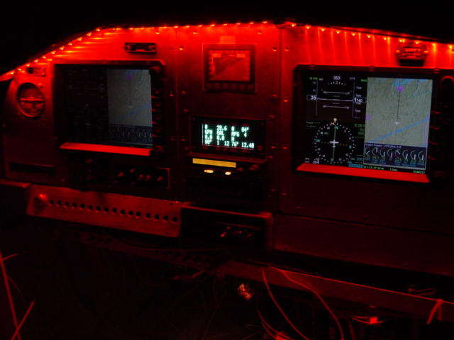

Hi Ernest,
Yes, I'm using the MPJA pwm speed controller for dimming LED's. In the
attached jpg. you can see the string of led's across the top of my panel
which are controlled by a single MPJA speed controller. I too
repositioned the potentiometer with a remote unit of higher quality. All
of my circuits were configured from the manufacturer to operate on 12v
as the MPJA pwm speed controller is designed to operate a 12v motor.
Works great with no noticeable flicker.
Mark S.
