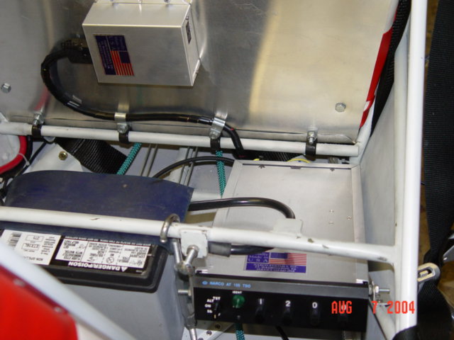

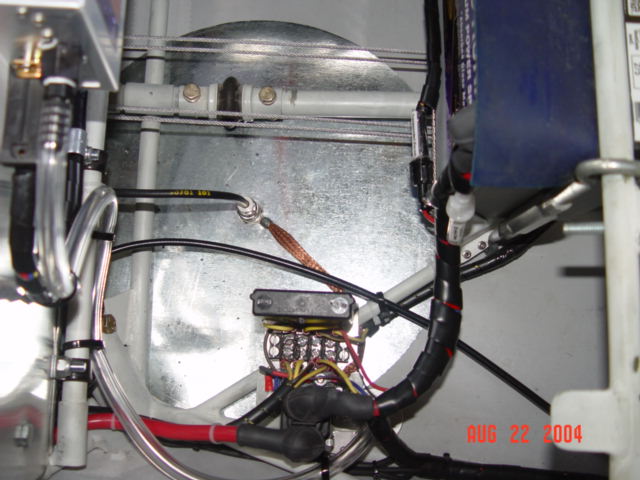

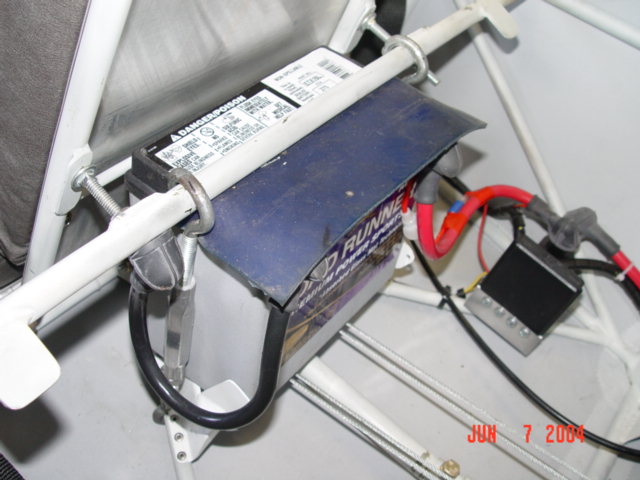

Here is a link to some installed pictures of the battery and hotbox in a
FSII.
http://www.bcchapel.org/pages/0003/FSII%20Hot%20Box.html

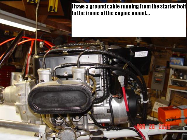

Ground the battery to the airframe, and ground the engine to the airframe.
If you put the battery where we have ours, or anywhere close to the rear
seat, it will work out ok because it will be close to the cg.

Here's some pictures,
I had to bend the cross tube "up" a little for clearance...I used a
bottle jack...
Although I'd rather have it in the nose of the plane
( I'm carrying 16 lbs of dead weight up there )
