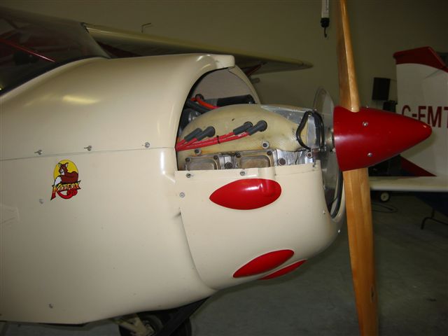

Posted: Fri Sep 01, 2006 4:10 am Post subject: Jabiru 2200 conversion |
Hi
Here are a few photos of the cowl on my Model4 with Jab 2200.
The main changes on this installation relate to a bump on the Pass side
front cowl (about 4" x 2" to clear the No.1 rocker cover and cut outs in the
ring cowl to fit the inlets in the to ram air ducts. The rest of the front
opening is closed using clear lexan so that the cowling is not pressurized.
There is also additional opening and some aluminum fairings in the bottom of
the cowl to allow sufficient air flow through the cowl.
Like Michel my CHT and oil temps run on the low side of recommended
operating range.
If you would like more detailed photos I would be happy to send them off
line
Gary Algate
Model4 Jab2200

Hi, I looked at the pictures, nice. I thought that the Jabiru turned the
opposite to normal engines. Your picture shows a normal turning prop.
Clint

Indeed, the Jabiru turns in the "normal" way, that is, you have to
press right pedal when you take off. The only engines that turn the
prop the other way are the two-strokes Rotax, as far as I know. Another
thing that is "normal" with the Jabiru is that, if the throttle cable
breaks, a spring will keep the carburettor to WOT, and not idle like
the 582.
Cheers,
Michel

Wow, Gary, I was just looking at the heads on your engine, and noticed
how much more fin area I have around the exhaust pipe. Mine is the
newer engine, with larger heads, but I never realized how MUCH larger
'til I saw your engine. I had never seen a picture of the earlier
engine 'til now.
Lynn

fin
area you must have great temps.
As mine is a tail dragger my oil level is pretty difficult to set so
I have
been gradually increasing to get a reading mid way between the high
and low
mark on the stick. On the weekend I went for a flight and it emptied
about a
pint of oil into the overflow canister and the belly of my plane.
I ended up dumping all of the oil and refilling it with correct
capacity but
it hardly registers on the dip stock when standing "3 point".
I checked with the Jab dealer in Canada and he said that this is a
common
occurrence if you overfill the oil.
Just when I had become really confident in the engine. Oh well
Gary Algate
Classic 4 Jab2200
re
engine 'til now.
Lynn
