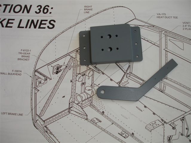

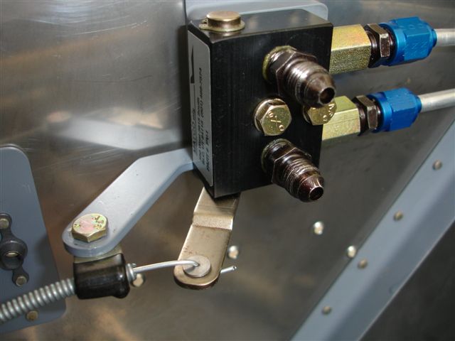

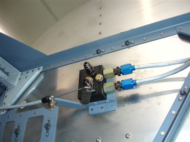

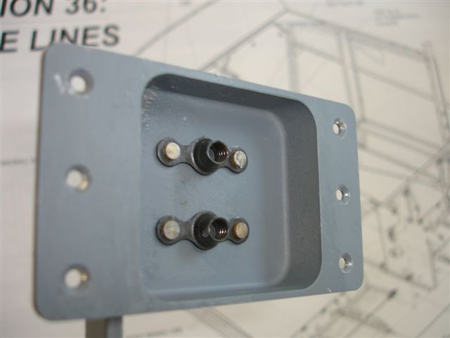

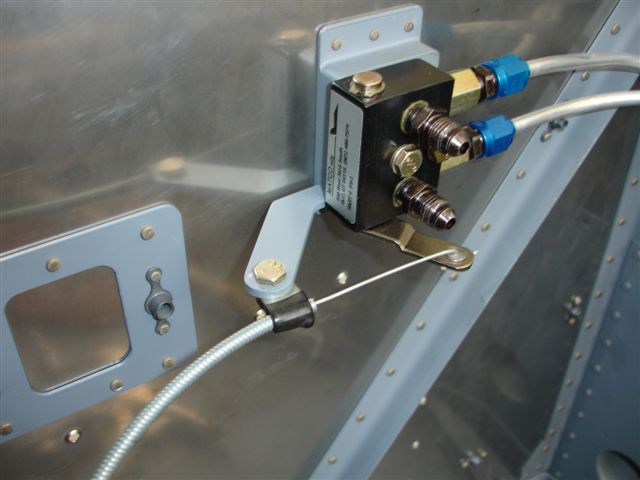

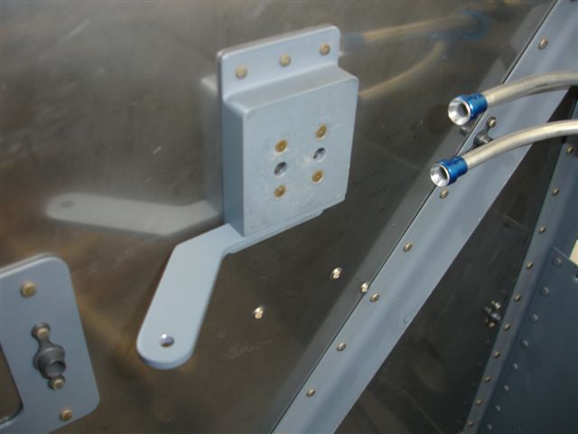

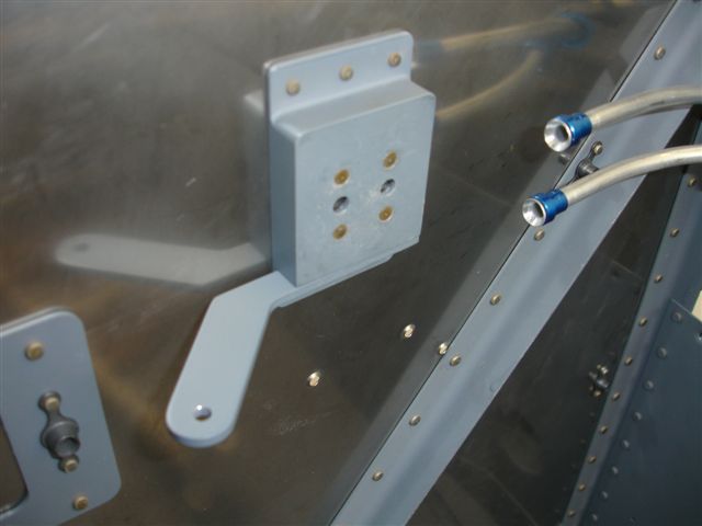

Guys,
Below are pics of my parking brake valve setup for the Matco Parking Brake valve. The bracket uses the existing holes in the firewall except for the middle 2 which are filled.
Zack

Thanks for the reference pics. Looks real nice.
