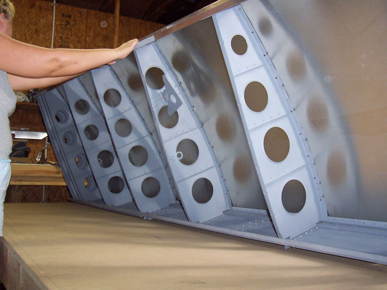

I did, put angles on all of my ribs, not just the first 4 as the plans show.
I liked having the angles on all the ribs... I've been told by a few people,
who have never scratch built a plane, by the way, that this was totally
unacceptable since it 'wasn't by the plans', but I really don't foresee a
problem, and I'm not afraid of this from a safety perspective.
I've attached a picture of my right wing so you could see the angles I've
added.
