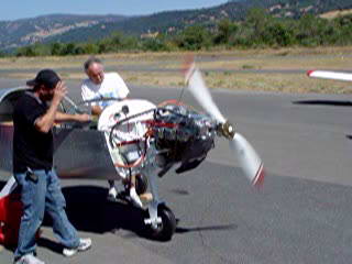

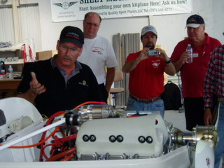

craig(at)craigandjean.com Guest
Posted: Wed Sep 20, 2006 8:51 pm Post subject: Zenith 601 / Jabiru 3300 Installation Seminar |
| Quote: | > I believe that I read recently that someone else did it in a weekend at
Michael's place on the west coast.
Yes, Jim McCormick of Jabiru Pacific ran a installation seminar at Quality
Sport Planes the weekend of September 8th. The engine was uncrated Friday
morning and spun the prop around 3 PM on Sunday.
If you are buying one of these engines you should really try to attend an
installation seminar.
I've attached some (very small) pictures.
-- Craig
