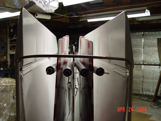

My plane IS equipped with the aileron counterbalance rods (thanks again,
J.Hauck), but they are slightly shortened to accommodate wing folding.

Dennis, You say the counter balances were shortened. Are they still in balance? If in doubt, disconnect your aileron push rods at the aileron bell crank and check. The combination of patch and shortening could very well be the cause of a flutter episode. It certainly sounds exactly like my first flutter incident. Airspeed was about the same, and it did come and go like that at first. I had no counter weights. Installing them and doing a careful balance has the flutter threshold beyond 120 mph, now.

DaveDid you re-balance after shortening the rods and reworking the aeliron? Could be it.

Dennis,
You've got enough responses to your question without me adding two
cents. But I'm addressing the shrotened countrerbalance weights. I had the
same problem on my Firestar - too long to get into the trailer. You can
drill holes to mount the weights in the "correct" length, then when you're
getting ready to store the plane in the trailer, remove the bolts, drop the
rods down to where they are now and temporarily re-bolt them. That's what I
did with my Firestar. You only have to remove and replace two bolts so it's
not like a major job.
AzDave

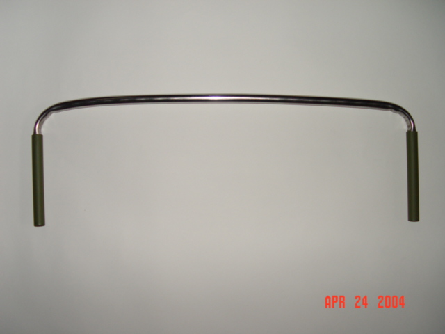

Hey Guys,
I didn't like the way the counter balancers "stuck out" when the ailerons were in the folded position .... So I made a cross brace to hold them pointing straight up.... ( and I tow it with an OPEN trailer )
I put a rope on it and a red flag with bugie to the tail wheel...
Aslo I didn't like how they rubbed on the tail when folded...
Here's a picture of the simple brace that I made...
Gotta Fly...
Mike & "Jaz" in MN
 Filesize:  60.25 KB
 Viewed:  600 Time(s)
It just slips into the same tube as the counter balance rod...
 Filesize:  60.7 KB
 Viewed:  626 Time(s)
