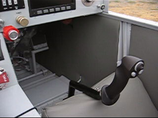

Hello group ,I have a question . Is it worth the effort to add dual control sticks to this design .What are your thoughts pro & con on this issue . Thanks Wade Jones

I am using the dual stick option. I found it awkward in the demo plane to change hands to check my ability to reach across the panel with the inboard side hand. I'm sure it would not be a deal breaker either way. With dual sticks the center console area is freed up for the placement of fuel selector valve, switches, whatever.

I went with the dual sticks because I am used to that configuration and like to fly with it.
I have flown both configurations and prefer the stick although there are some disadvantages.
Some of the drawbacks to the dual sticks on this aircraft are:
The loss of foot space in front of the pilot and passenger.
It is harder to enter and exit the aircraft.
The wiring and placement of some items require much more thought.
The seats must be configured for the sticks.
The stick interferes with the passenger seating comfort.
It is harder to carry cargo in the passenger seat without interfering with the stick.
Some of the advantages of the dual stick are:
The console area can be configured for instruments and other items.
The right hand is free to set radios and other instruments. The right hand is free to write.
The aircraft can be flown with the left hand when you wish.
The stick can be configured with switches that can be operated with either hand.
I personally find it easier to fly with the stick than the center control.
The legs can also be used when necessary.
My two cents worth.....

Wade, I actually held off starting the Zodiac until they offered dual sticks. I am not a mancho "left hand on throttle, right hand on stick" type. I learned in your everyday spam can, with my right hand on the throttle and left on the yoke. Beyond that, my other problem with the center stick is that I am right handed. I could not envision grabbing the stick with my left hand in order to write something down (with my right hand) and I can't write with my left hand.
That's my 2 cent's worth, Jay in Dallas, working on XL canopy [quote][b]

Well, I'm doing it for a few reasons:
- it mimics the planes I have trained in (172, Katana, Evector, 601XL): left hand on the stick, right on center throttle.
- all the 601xls that I have seen that have been purchased for flight instruction have dual sticks. So if you need time in an XL before flying yours you will probably need to use dual sticks
- I am right-handed and wanted that hand free for things that require manual dexterity: writing, fiddling with the GPS, radio, transponder, microwave over, etc.
Certainly the center Y stick is a cleaner design. Others will say that it is not a big deal to grab the Y stick with your left hand to temporarily free your right for other tasks.

One way to address some of these problems is to make the upper portion of the passenger-side stick removable.

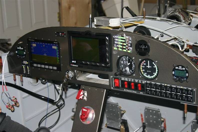

All the opinions I've read are good and worthy ones. In my case, as a CFI I'm used to switching hands and going between wheels and sticks and having to stretch across the cockpit to reach things. For most of my career I owned a Cessna and an Aeronca Champ (still have the Champ.)
I chose to go with the center stick for 1.) Simplicity 2.) Comfort (nice armrest leading up to the stick instead of curling your hand in your lap.)
3.) Easier entry and exit. To deal with the other issues I will simply design my panel for easy placement of controls (and duplicate some on the right) and install a single axis autopilot to do the flying when I need my hands or am otherwise engaged. Anyone who has flown single pilot IFR and tried to copy clearances, twist radios and the like while in IMC knows the value of an AP. If you don't want an AP, remember the "poor man's auto pilot" (rudder pedals) which can be used to keep the wings level on an otherwise properly trimmed AC.
In the end, there is no best choice..... just go with what works for you.

Paul there is no reason whatsoever, Chris Heintz designed the center stick and for nearly 22 years it has been nothing short of a great system. It is truly the best way to fly the 601 of any series. However, many who have never flown with the system wanted something more conventional as dual leg smackers or if you have wet shoes then they are called ball breakers. If you’re panel is laid out properly then in the first and last 1000ft everything you need can be accessed by your left hand. If you need to write down information then I sure hope you got it before you entered the circuit like you’re supposed to a properly trimmed Zodiac can fly for large amounts of time hands off. It is funny anyone who has built there second Zodiac still retains the “Y” stick and any seasoned 601 owner can easily modify the system to a dual stick but never seem to. All arguments over changing from a “Y” stick configuration are simply those who are afraid to get used to something different. But it is a personal choice, and to each there own The 601’s in Canada owned by Flypass were used for a great many years as flight training planes and retained the Y stick plus when many of those students built there own planes they didn’t install a dual stick configuration either. This is not an argument, I won’t have a dual stick setup in my plane, it is a personal decision and preference, amazingly enough I find the Y stick more social then a dual stick ( never could figure that one out but it is true to me anyways). Any debate of one being better then the other is totally false and wrote with personal preference. Below is an early picture of my panel for the 601XL. Let the scotch bright pads fly !! Remember I did say personal preference !

I wondered the same thing. I sat in Bob Archibald's XL (Dragonfly Aviation)
and ran the stick to all four extremes, shooting a movie with my digital
camera. It will hit the seat if pulled way back. But after flying the plane
I saw how sensitive the controls were. If you pulled the stick back a
quarter of that distance you would (with enough power) loop the plane.
The whole movie is 7.6 megabytes. If anyone wants it, let me know and I will
e-mail it to you.
-- Craig

The stick movement in actual flight is very small but to get full movement the seat cusion needs to be relieved the same as an RV or other similar dual stick aircraft.
Mike Sigman
