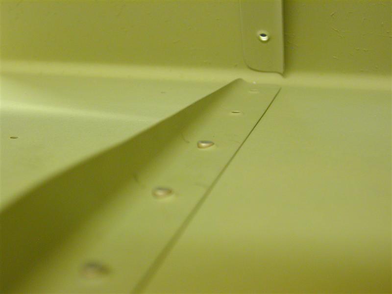

I know you experienced folks get tired of the "is this crappy rivet ok?" bit, but I gotta post another one. I'm back riveting the stiffeners into the rudder and elevator skins of an -8. The rudder stiffener rivets turned out fine, but upon inspection of the bottom side of the port elevator, I found about 1/3 of the rivets look like the pictures. Essentially, the shop head is flattening half of the dimple.
These are the 3.5 length rivets as specified on the drawings. I'm match drilling to #40, then dimpling. This sure seems to give an awfully big hole for the 3/32 rivets to move around in, although the rudder turned out ok.
As far as I can tell, my surface (back rivet plate) is level and the gun is perpendicular. The working pressure is about 44 psi (avery 2x gun).
I seem to get slightly better results by driving the rivets very slowly.
Any advice to improve my technique??
Jeff[img][/img]

Jeff, this isn't particulrly unusual. But you're not holding your rivet set
completely perpendicular to the piece. Also, be sure the skin is not lifting
off the backrivet plate at all.

<?xml:namespace prefix="v" /><?xml:namespace prefix="o" /><![endif]--> It is true about the skin lifting up off the back riveting plate. For lack of anything better, I triple bagged some sand in one gallon zip lock freezer bags from the kids sand box and placed one bag on each side of the stiffner I was riveting. The instructions do mention weighting it down as you rivet. After a couple of partial flat dimples, the light bulb went on. It really helps with the elevators.

I used -4 rivets there and for most of where Van's calls for -3.5's. I
never can make 'em come out right when they're too short. I usually
measure up the first one with a rivet depth gauge (Avery or Cleaveland)
and use whatever size will work the best. Places where there're more
layers, I measure again.

Anyway, he wasn't happy with how the 3.5 rivets were working out for
me after the first couple, so had me try 3.0's. Which although just a
hair shorter than they should be, they easily made perfect shop heads
of the right size. So we used the 3.0's for the rest of the
stiffeners. (Hmm... not sure if the kit comes with enough 3.0's, but
he had plenty for me to use).
From my less educated perspective, it seems that the 3.5 is a hair
long for the thin skin of the elevator, and the 3.0 is probably a
hair short. In any case I was able to make consistently good shop
heads with the 3.0's rather than the 3.5's called for in the plans.

I too don't understand why the "3/32" rivets are so small for the holes. If the rivets were .100 inch instead of .094 they would fit much better.
Now I'll give another plug for pre-squeezing the rivets. Use your squeezer and squeeze a batch of rivets until they just fit the holes before you even start to rivet. Once you have the squeezer adjusted this goes pretty fast. Now when you start banging on the skin, you won't spend the first 4 or 5 hits bringing the rivet shank up to size. The now shorter rivets are not as likely to bend over, and the shop heads form almost as soon as you start the gun. The result is a much better job. You don't have to start with longer rivets -- that would defeat the purpose. Use the gauge before you pre-squeeze.
I built most of my plane this way and I get lots of unsolicited comments about how good the riveting looks.

I use half that pressure and only about 4-5 hits with a 3x gun when back
riveting onto a steel plate.

Your pressure seems very high. I also have an avery 2X gun and only use
25 psi for these rivets. I only go up to the pressure you mention if I
am setting the longer lengths of 1/8" rivets.

Thanks Gents. I'll experiment with each. Think I'll start with reducing the pressure at the gun. Maybe not banging the snot outta the rivets will help. Be gentle with the rivets, the rivets are your friends; right??

Yeah, make sure you don't hit it too hard, but also not too light or too
short a burst. That is, don't harden the rivet, which can happen with a
series of bursts. Try to get it set in one burst, not multiple bursts,
probably at most 4-6 taps of the gun should do the -3 rivets. You got to
have that certain rhythm, ya know.

I have found that if I hold the backrivet tool perfectly perpendicular to the surface, the rivets come out looking like crap and look pushed over. I soon learned to lean the backrivet attachment towards the upward angle side of the back stiffener to make the back rivets come out perfect. That don't make no sense, I know, but it works. Here's my entry on my website about it (about 5 pictures down):
