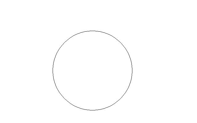

Posted: Tue Nov 07, 2006 5:36 pm Post subject: Large format printer referral??? |
Actually I was referring to the limitations of delivering engineering
drawings as jpegs. Attached is a jpeg of a circle. The jpeg is 640 by 400
pixels. What size should the circle be when it is printed? Unless some
assumption is made about pixels per inch it is impossible to say.
For the jpegs that come out of my cameras (as opposed to being drawn like
the rib templates were) the EXIF information in the files say:
X resolution: 72
Y resolution: 72
Resolution: inch
Is that resolution information useful? No - but it is in the jpeg.
-- Craig
