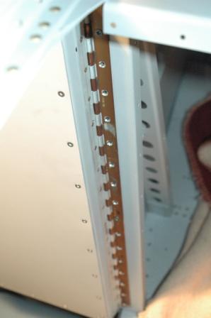

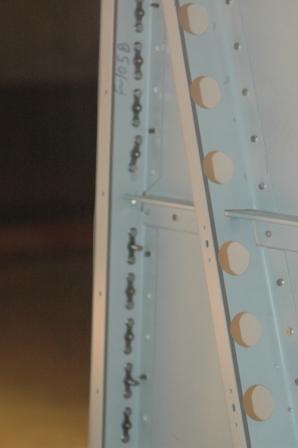

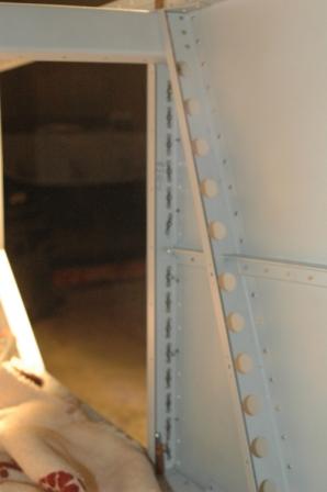

PostPosted: Thu Nov 09, 2006 7:03 am    Post subject: Baggage Door Hinge Reply with quote
This morning I drilled out the rivets holding the hinge to the frame and replaced them with number 6 nutplates and screws. It worked very well. The two things I did is not to fully countersink the hinge for the head of the screws as its not very thick and its not necessary as there is some clearance when the door is closed. Second I left out the nutplate in the middle of the frame as it inteferes with the longeron. The longeron could be trimmed slightly at this location and the nutplate added if one deems this necessary as it ends at this location i.e. there can't be any load in it. Overall it took 2 hrs. Another item that makes is relatively fast is that since the nutplate holes are considerably larger than the existing #3 rivet holes drilling out the rivets goes considerably faster as one does not have to be as carefull.
Niko
40188

owl40188(at)yahoo.com
PostPosted: Fri Nov 10, 2006 7:34 am    Post subject: Baggage Door Hinge Reply with quote
Well , here are the pictures. I am really happy with the way this came out. Its a worthwhile mod.
Niko
40188
