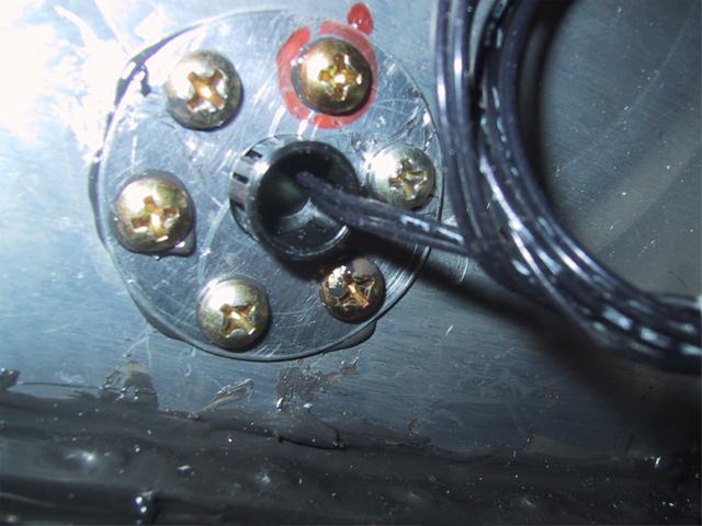

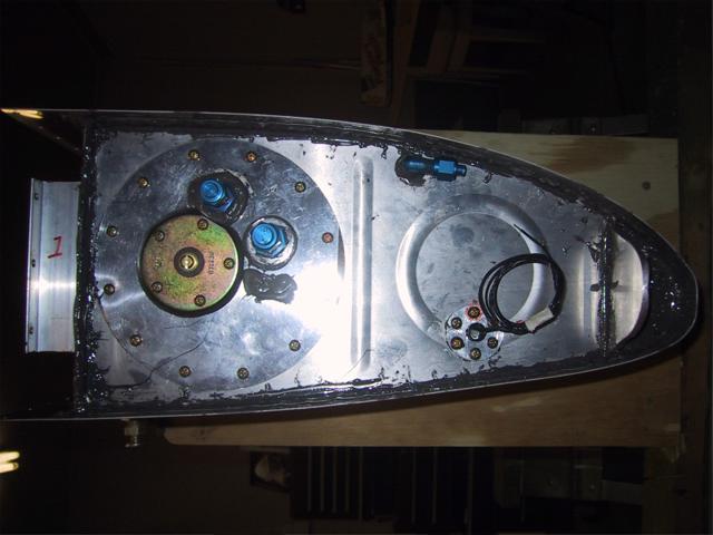

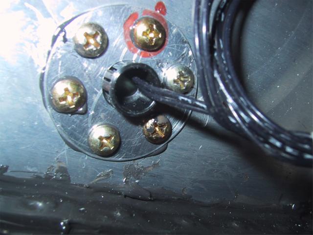

My RV is equipped with float switches that turn on a warning light on the panel when there is about three gallons remaining. The switches are available from Aircraft Spruce. They have a pivoting float with a magnet that closes a reed switch when the float gets down to a certain point. I mounted them in the ends of the tanks with weld able flanges. (Also aircraft spruce) However I did not weld the flanges to the tanks. The flanges are wide enough that there was plenty of room to drill and tap them and fastened them in with screws. I sealed them in with Pro Seal.
Aircraft Spruce also has an optical system for detecting a low fuel level. It works (I think) by directing light into the fuel tank and looking for a reflection. It was more expensive than the switches.
I plan to use the same float switch system on my 601XL
Carroll Jernigan

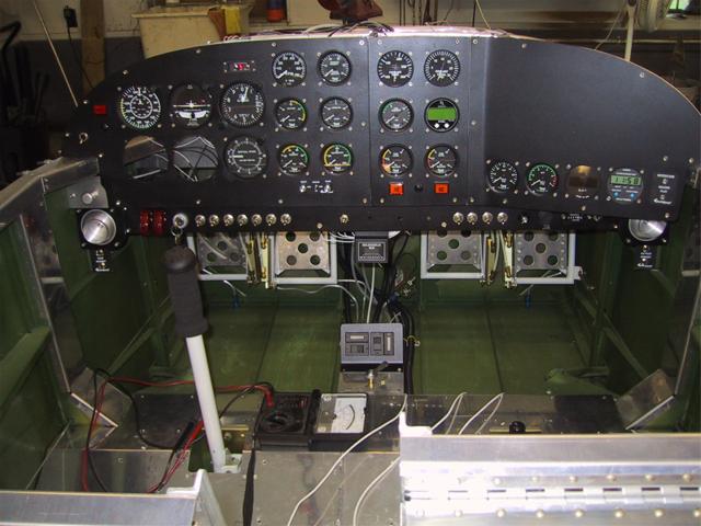

I'm going to add one more picture. The two lights just below the fuel indicators are the low fuel warning lights. The button between them is a "push to test". The lights appear to be red in the picture but they are actually orange.
Carroll

The ACS part # for the float switch is 6905-400. The flange I used to mount it is AN867-4. I used the panel lights that ACS recommended because I liked the way they looked but a LED could easily be substituted, and as Paul said a LED would be cheaper and more reliable. I still like the "press to test" feature. I sold the RV before it was completed so I don't know how well it is working. I did test the system when the wing tanks were being tested and it worked perfectly. I do suspect that there might be some premature flashing with reduced fuel load in turbulence, but then that's a warning too.
On my 601 I plan to install the sensors further back in the tank because I think the warning lights might come on during flare with them mounted as far forward as they are in the RV. As soon as the new owner finishes flying off the hours he's going to let me get some time in it, so I'll know more then.
Carroll

No. It only has one set of contacts. But if it was mounted high in the tank it would turn off when the fuel level rose above it. It could also be inverted to turn on when the fuel level reaches it. Not sure what that would be good for unless you wanted a full tank warning.

This is an optical low fuel sensor sold by Pillar Point Avionics:
www.ppavionics.com/LFL.htm
They also use the same sensor in a system which automatically transfers fuel from wing tanks to a header tank.
Aircraft Spruce sells a similar system made by Aircraft Extras:
www.aircraftextras.com/FuelSensor1.htm
