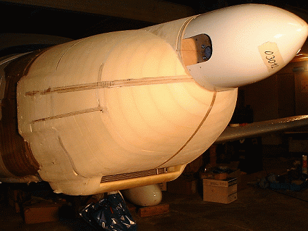

Has anyone changed the cooling air intake location and shape (diffuser)
for a XS / Rotax install?
It seems that if the duct was slight shorter with a proper shaped lip,
something like the Katana Extreme photo attached, may be a better
mousetrap??
By having the entrance of the diffuser airfoil shaped, if done properly
with the flat side on the inside, it could decrease speed and increase
pressure which is exact what we want, and even give a bit of forward
thrust.
Also included a picture of Gilles diffuser.
Ron P.

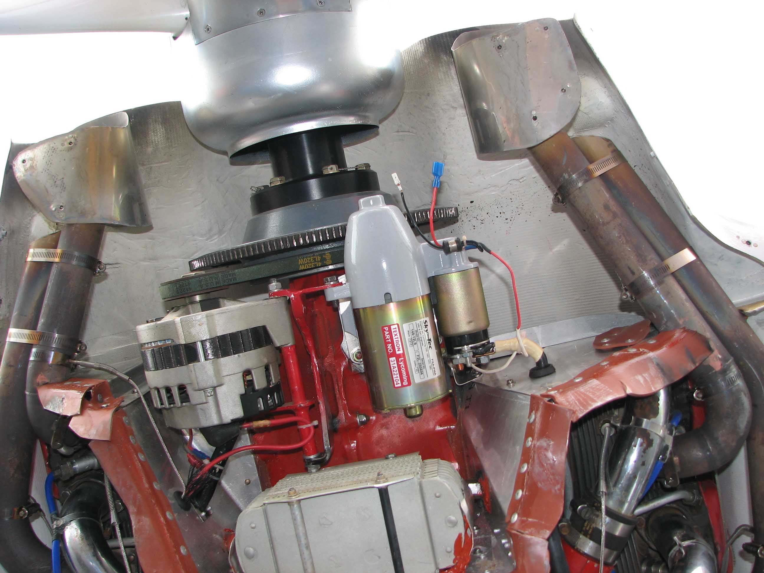

Another way to improve cooling on the ground is exhaust extraction, this
is how the EZ boys do it. I don't think anyone has tried it yet on a Europa.

grahamsingleton(at)btinte
PostPosted: Mon Dec 04, 2006 3:22 am    Post subject: Cooling diffuser Reply with quote
Ron
I will attach a pik. Problem with Europas is the gases can get sucked
into the cabin, but that could be cured I'm sure.
Graham

True. Now this is much less of an issue when the inlet is located far
from the propeller center line,at the bottom of the cowl, for instance.
My own fix for the Europa cowling is a variable air scoop, below the
existing inlet, ahead of the radiator. Theoretically it is very bad,
but it works! It works because this additional inlet is located
farther from the propeller axis, therefore receiving more air flow.
Sure this adds a lot of drag, but who cares about drag during taxi
and run-up? The scoop is positioned back to neutral just before take
off and can be closed to blank the radiators at cruise and descent at
cold temperatures.
I wanted to be sure to build up as much static pressure in the intake to
cool efficiently, and still have enough pressure left after crossing the
radiator, to exit at as high a velocity as practical. The goal was to
cool and still achieve lower drag.
