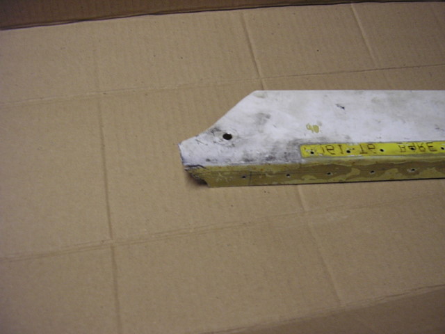

Any way we can get a photo of the crack? I'd like to make sure I know exactly where it is developing.

s.c.richards(at)homecall. Guest
Posted: Fri Dec 01, 2006 2:05 pm Post subject: Crack in 601HD firewall stiffner 6F8-2 |
Gig
Photos attached as requested showing position of crack & cracked end with
stiffener removed. The piece which broke off is not to hand.
We have replaced stiffener but left end wider over engine mount and taken
strengthening angle above across full width of fire wall.
Clive

Thanks for the photos. The earlier poster was right the XL has beefed that area up some But it will go on my list of places to watch anyway.
