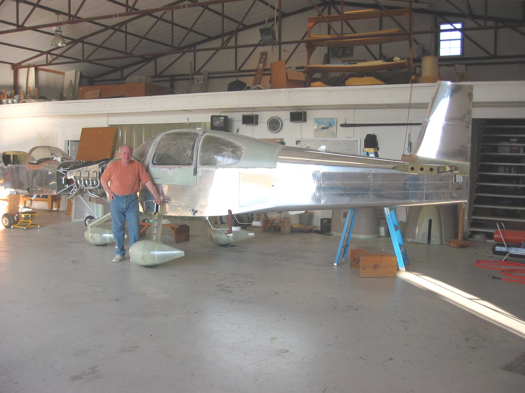

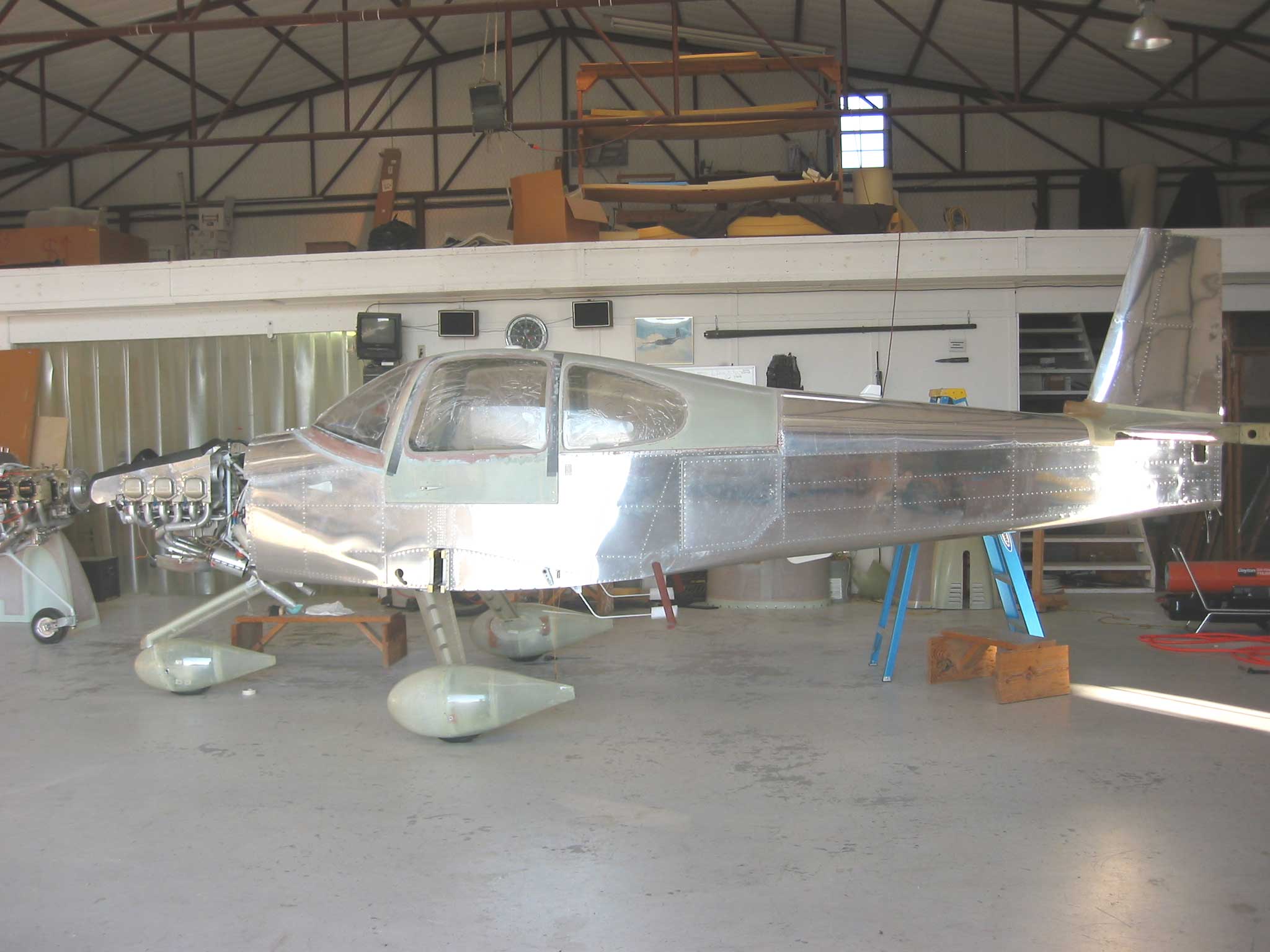

I've got my fairings installed and I would definitely put them on before you install the wings. The engine being mounted, mine is, wasn't really an issue for me. Your going to love this job, it was a little work to get this done or at least it was for me.
I've attached a couple of picture so you can see how much easier it is to get at the main gear fairings without having to crawl under the wing.
Wayne Edgerton #40336
