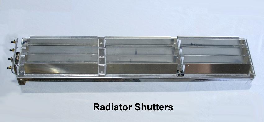

There is a start up company - HighWing LLC (Yes I am involved) that has a
radiator shutter kit for the Skystar supplied radiator for the 912 series
engines. It is an easy assembly and attached to the radiator with Nylon Tie
wraps. It requires a Button Lock dash control like the A-700 from ACS for
operation.
For other radiators, an exact dimensional drawing with location of the inlet
and outlet accurately depicted and we will make up jigs from that.
Attached - two photos. one installed in a Speedster radiator shroud and one
uninstalled.
If anyone is interested drop an off list note.
Lowell
