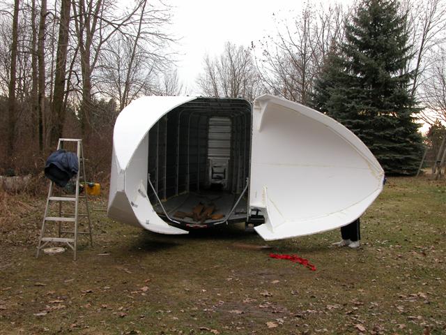

I just did my first test fitting of my clam shell doors on my Kolb trailer. The trailer weighs about 1000 Lbs. empty and will hopefully be able to be pulled by my Toyota Sienna. The clam shell doors are made of foam board then fiber glassed. The frame was a boat trailer that I added a tube framework to and covered with pole barn steel. I wanted to have it ready to pull it to Florida this year but it just isn't going to happen.

Rick, Looks good. It looks like yu took Homer's and my advice about using simple curves extended off of the top and sides of your trailer. How much do they weigh?

Perty slick, Rick. You put some serious thought and effort into that. Lar. Do not Archive.

They weigh 10-15lbs each. The heaviest part is a 3/8" X 5" X 6' plywood part that is glued and glassed to the foam where I attach the hinge. I set one down while I was mounting to other and a 10MPH wind was blowing it around. I only glassed the outside of each door. Each door is a bit fragile when open but should be stronger when both are closed and latched. I will also be adding more foam bracing on the inside. The caned foam "tough stuff" makes a real good foam glue.
I was right on track to get the trailer ready for Florida but the weather turned cold around here and the resin took for ever to cure.
Thanks for you help.

That's pretty cool, Rick. Does the plane extend into the clamshell portion or is it just empty space?
It would be interesting to compare gas mileage with and without the doors.

Rick, if you decide to glass the inside of the doors, or do another large
part, try using electric blankets to help cure the epoxy.

If you glass the inside the stiffness will increase 5 fold.
