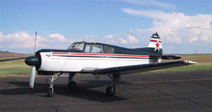

Un the Sukhoi and my SP the whole cowl is MUCH stronger than the standard 50/52 cowl. For example, the front of the cowl is shaped like a wing there is baffling on the inside of the cowl that gives great strength. Also there are support arms from all cylinders to the cowl (see attached picture) I bet you have wondered what those bolts on the front of the cylinder were for, well guess no more because they are the mounting for the support arms.
The diameter of the cowl opening is also slightly smaller hence the gap on a 52 cowl when the flaps are closed.
Hope this helps
