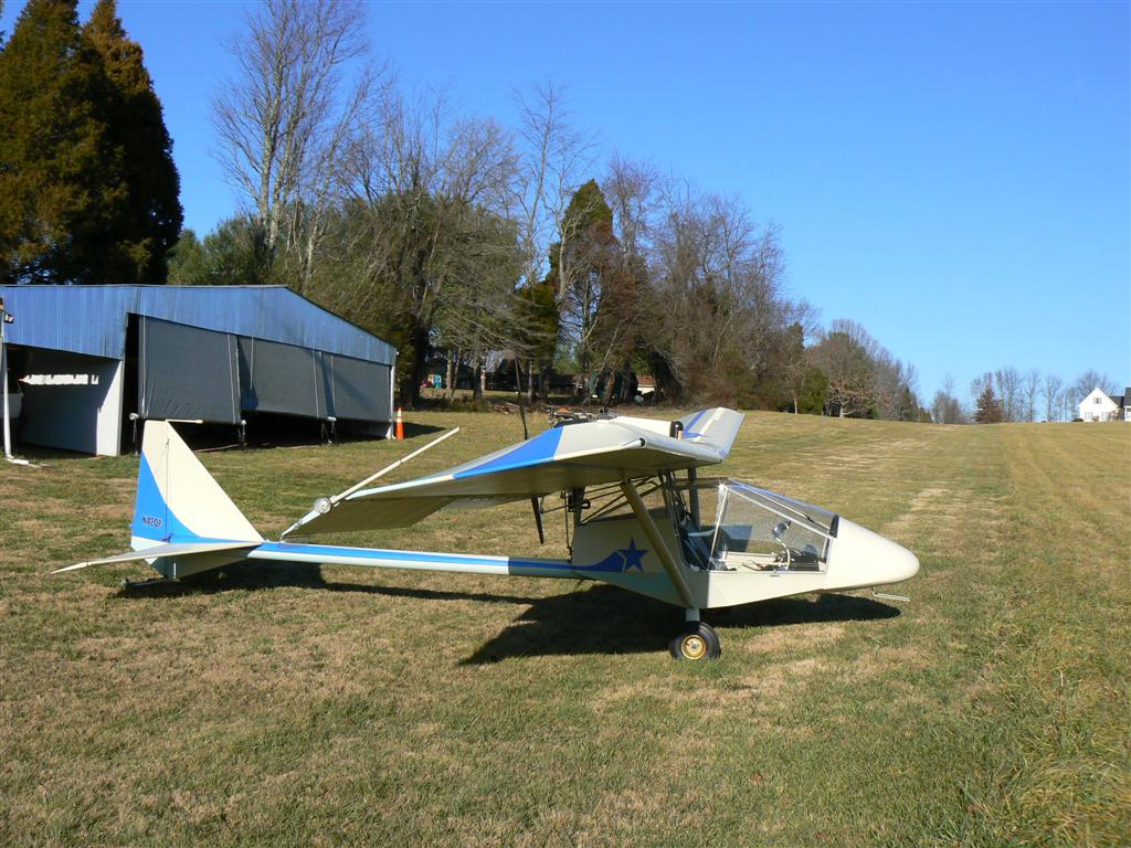

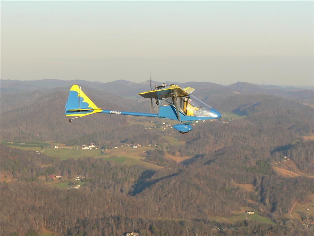

Since the FSII flew hands off so well with a bunch of dihedral, decided to try it on the MKIII and see if it could also be made to fly hands off. You can see from the pictures how much dihedral is in the FSII, and how much is in the MKIII, but the results were not at all alike. Could not come up with a combination of trim or throttle settings that would enable hands off flight. It was better than before, but just barely, it was still impossible to pick up a low wing with rudder. There was a small amount of turbulence, but very small. Perhaps if I had a passenger so that it was balanced on each side, and the air was glass smooth, or maybe if I had a full fuselage that ran up to the base of the wing - who knows?
Anyway, my initial tests show that dihedral is of no apparent value on this MKIII, your results may vary. None of the other flight characteristics seemed any different. Will probably put it back like it was. The gap seal fits better that way...

On a different note, my original Firestar has a canopy like the FS II in the picture and the top of the fuselage sides (under the wing) are open as well... Thinking I might cut a little wind and noise, I covered the openings with Lexan and went out flying... The coverings cut my airspeed considerably, I removed them and things went back to normal... A buddy flying beside me, said he could see the difference in AOA with and without the coverings... My theory is that the coverings robbed air from the prop...

This one has a tapered Lexan fairing that goes behind the factory cockpit enclosure, and we have flown it with and with out the rear Lexan. Without the rear lexan fairing, the speed goes down, and it loses some rudder authority. Since we have the Lexan tapered, hopefully it enable wind to the prop.
